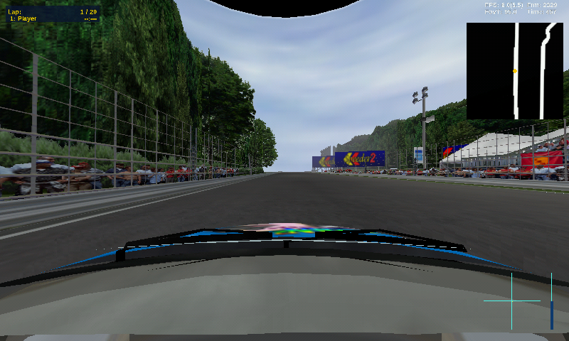

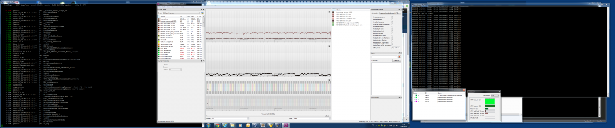

While working on my projects, I now try to use PVR Tools to get more insights on the bottleneck I have.
On SpeedDreams, in fact, the bottleneck seems to be CPU? The reading are a bit strange, as most of the CPU seems lost somewhere in the Kernel.
Here are some screenshot (desktop & pandora) to have some intel (beware, desktop screenshot is quite large)
Anyone as some ideas?
Have you tried to run it without Sound or another SGX for more Speed on the GHZ Model?
^_^
Sometimes a faster USB Stick or HardDrive give more Speed too.
MiniMenu gives little more CPU Power too or maybe you can run it without any X System in Backround?

ptitSeb, does the profiler differentiate between a thread being awake and a sleep? If threads are waiting for the GPU they can just be sleeping, so if the profiler is counting that as 'active' time, it'll appear as kernel activity (probably). Can't really see from your screenshot what is going on with the profiler (as in the details about the entries from top etc.)
I'm not sure. And I have noticed the forum downscale the picture. I may upload the picture elsewhere if you want.

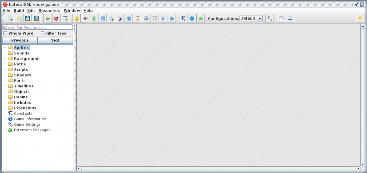

http://enigma-dev.org/docs/Wiki/Install:Linux
just for info
CJ
Ah yes, I forgot to tell you about this one. It's easy to get it running.
Just open a Codeblocks command line, create the env. variable REAL_HOME if needed (for the Java pnd) and follow the installation procedure (like git clone, the python script and java -jar lateralgm.jar) and it will work out of the box.
The lateralgm is bit to big for the Pandora screen of course, but it works with no issue.
Inside, you should be able to use either GLES or OpenGL renderer. But no shader, as it needs OpenGL 3.x to run.
My *only* issue is that I try to compile a few games (I tried like 5 or 6), and none compiled. Always an error somewhere, due to some obsolete call used or some unknown function. It's an issue with Enigma itself, not the Pandora version... I didn't investigate more to have something running.
But if you just want to create something from scratch, it should work flaswlessly.
Here is a snapshot of LateralGM runing on the Pandora, but display on my windows computer (launched from a putty session, using XForwarder), so without the Pandora screen limitation.
