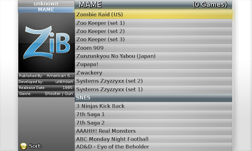

Pic shows off two improvements one the interface is almost down (scaling and what not) and the inclusion of catver.ini for MAME games. You will also notice that there are more than 0 games I am trying to find out how I broke that part of the program. :-P
Does anyone know of a good DB or catver like file for other emulators?
Great progress, and I have some suggestions. Working off of this photo-
Maybe you should consider making the black behind the lettering and the grey lettering thinner. Also, if there is black behind MAME, maybe it should also be behind SNES. That could help it come more in line with early interface concepts. Good work and I look forward to seeing your process.

I'm a little confused. Is the UI drawn more like a form type editor that you design not during runtime. Or is more of a
draw()
sidebar.Draw();
foreach(menu m in blahs)
m.draw();
Type deal. I'm just totally lost on how you're doing it. Maybe if you explained the process, I might be able to understand how to go about it.
I'm just a C# programmer, but I've programmed many a' menu for games. Just wondering how you're doing it.

No need to be confused. The Interface is written in a scripting language called edje which in turn is based on a canvas library called evas. The back-end is completely written in C with calls to and from the Interface. Though Neither can exist without the other the design (if done correctly) will allow themers to not only change the look of the icons but the placement of said icons and the animations of those Icons without touching the backend. It also allows for themes to be stored in a single compressed file instead of a mess of Images and scripts.
What game menus have you made Tiptup300? Had I known that you had any experience in programing the very thing we are working on I would've deferred the project to you a long time ago.
@PandoraRox
I don't believe I said all the fonts were correct :-P anyway I have all about 5 minutes a day now a-days to work on the program and the look is low on the list right now.

Did we ever discus the font that we are using for the menus and lists? Currently Im using vera which looks close to the renderings but not quite right.
