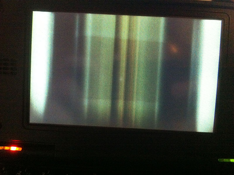

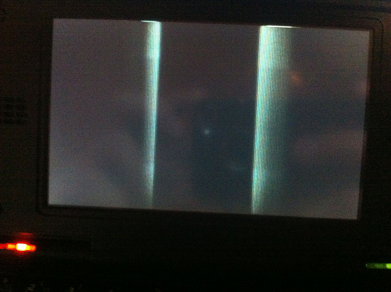

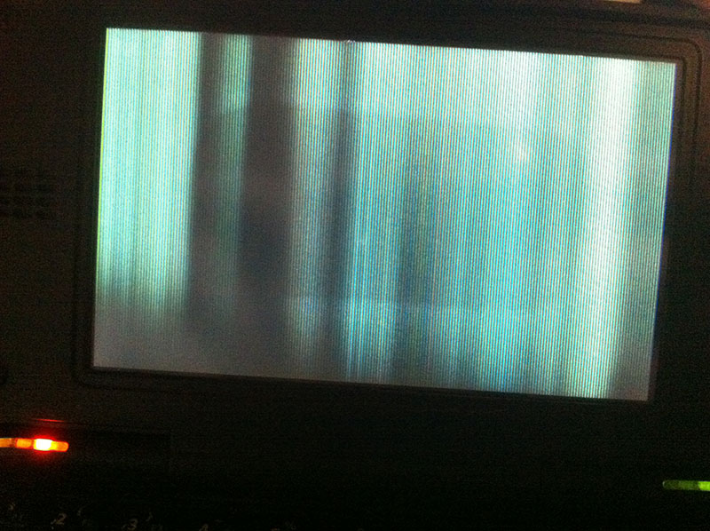

Hi all,
I got my Pandora this week, but I have the following problem with the emus PCSX rearmed
and SNES9X4P (both latest version), I get no picture when I try to start a game.
I see there only colored stripes on the screen (see attached) ... but I can hear the sound
from the game. Mupen+ and gpSP works fine. Does anyone knows a solution or
what is the cause?

I noticed when I start the pandora i can see the stripes for a second while booting!!
http://www.youtube.com/watch?v=MqwmtyrxlJo
I dont know what to do, I think its a hardware problem.
It can't be a hardware fault, because everything else is fine?

Do those two emulators use Notaz's scaling? Maybe only certain instructions/functions on the soc are defective.
Wow, lots of weird unexplainable problems lately..
All of mentioned emus use the same method of scaling, only aspect differs, still it doesn't make sense. Some rare SoC or LCD defect perhaps?
Well, with over 700 new units shipped out during the last months, some weird stuff is to be expected, I guess.
How does scaling work?
Is the LCD even affected by the scaling?
The SoC scales and sends an upscaled picture to the LCD... so is there something different for the LCD than a normal picture?
It more sounds like the SoC... is there some kind of testing we could do (scaling various resolutions, etc.)?
Yeah, OMAP does the scaling, but maybe enabling scaling has some side effects, like affecting pixel clock slightly or something..
That corruption during boot is an indication that LCD is different, my early prototype with low grade LCD does that too (much more severely), but it doesn't prevent scaling here, never seen that. Don't know about testing, there are far too many scaling possibilities (anything in ~0.25x-8x range for both width and height).
Para-noir, you can try to run PCSX and in Options->Display there is "setup custom scaler", there when you get the display loss, press right and down on the d-pad multiple times, maybe it will start displaying again eventually.
Well, we are already using a new batch of LCDs (about 200 new ones used up so far), but these are all Grade A ones (or should be) and are the exact same brand... hmmm...
I've seen this before and I just replaced the unit, I assumed it was a power related issue as the LCDs sometimes do that in low power circumstances (faulty battery, connector PSU etc.).
Okay, that means I have to send it back to ED for replacement.
Cant wait to get it back already.. :(
These stripes usually indicate a fault with the display, seen it too many times on other devices.
