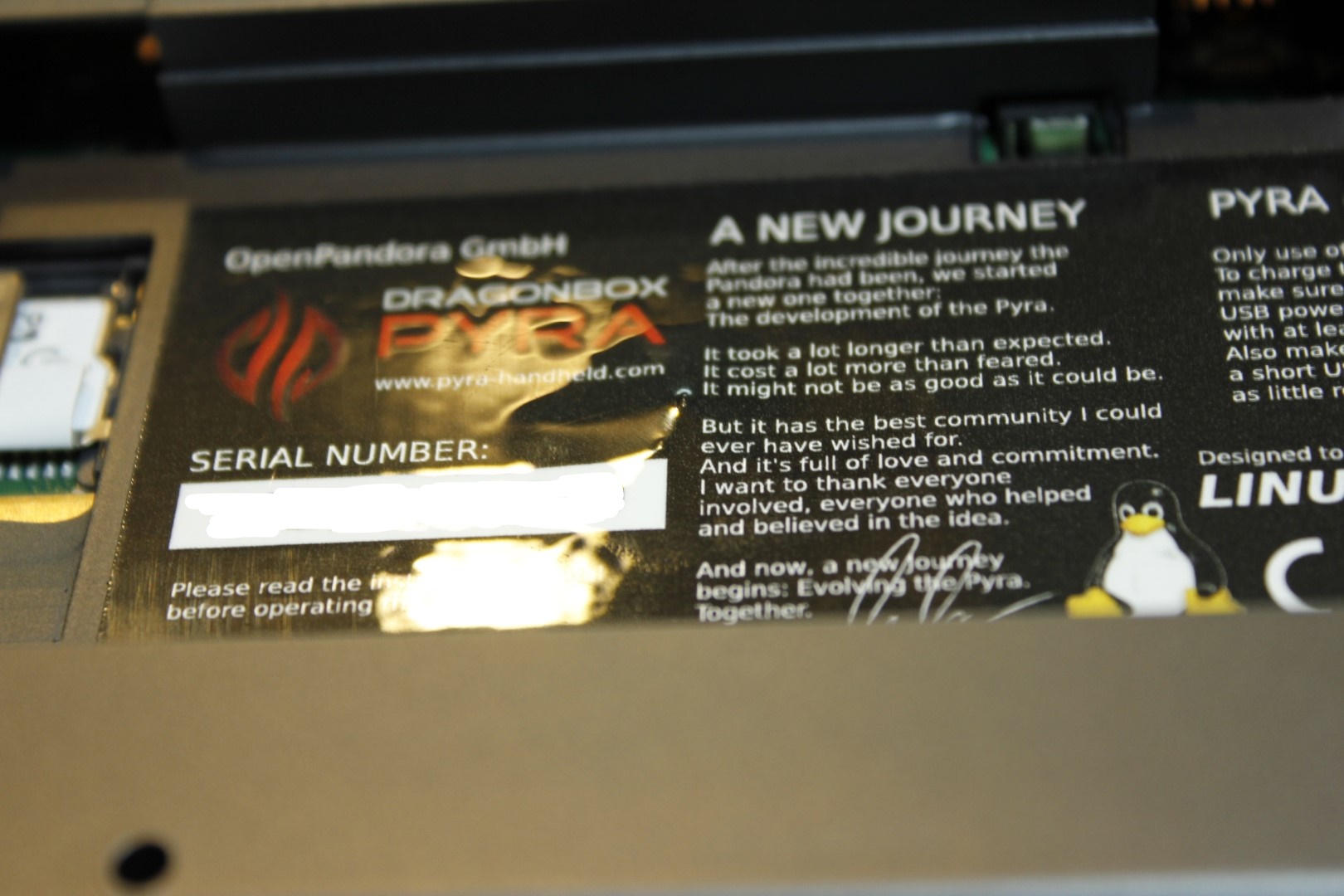

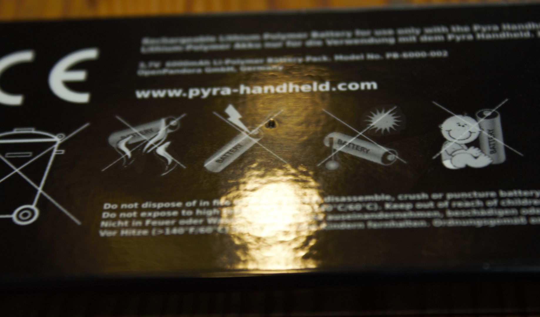

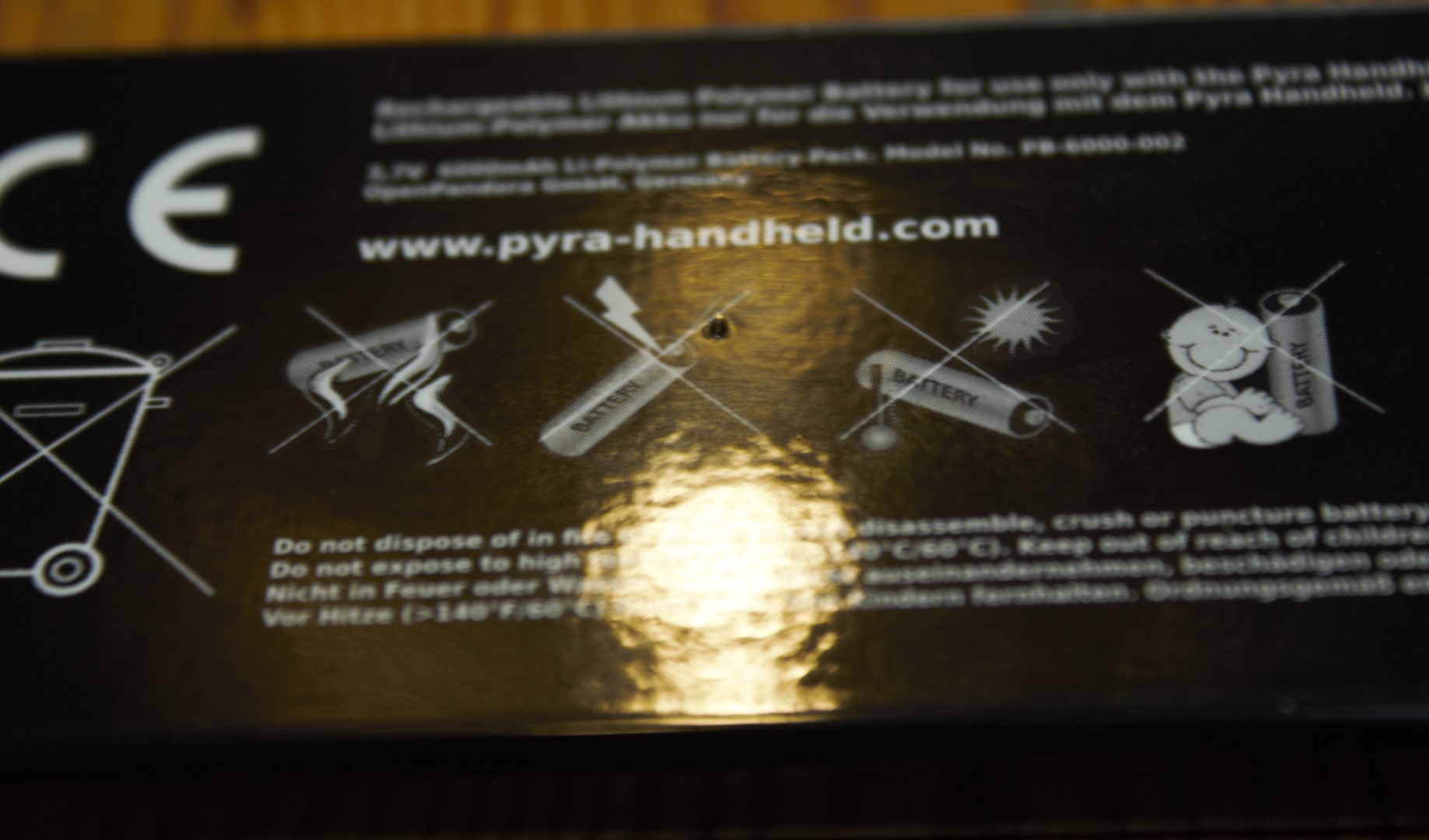

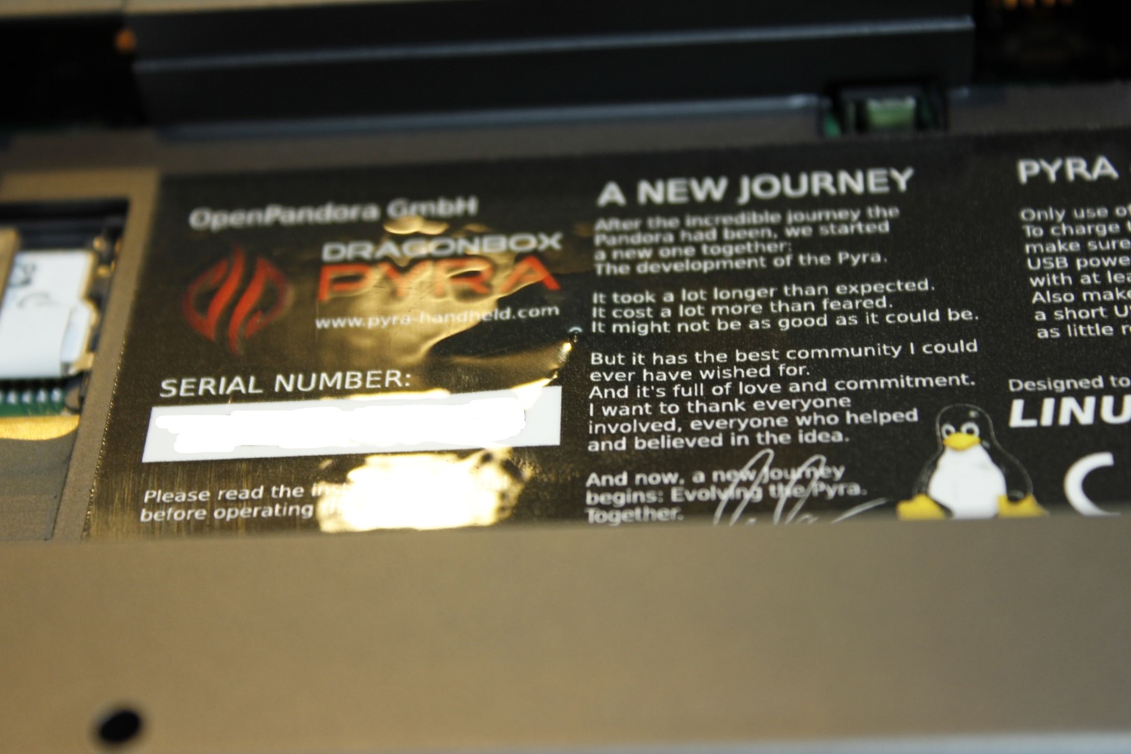

//Edit: Also I noticed that there is something poking trough the label in the battery compartment which also pokes the battery:
View attachment 36780View attachment 36781
All in all the device feels more like a early pre-production run than a polished device. It does not have the "premium" feel but is perfectly usable. As I said it feels a lot like the Pandora and I am perfectly fine with that knowing all the hurdles and the development story behind it.

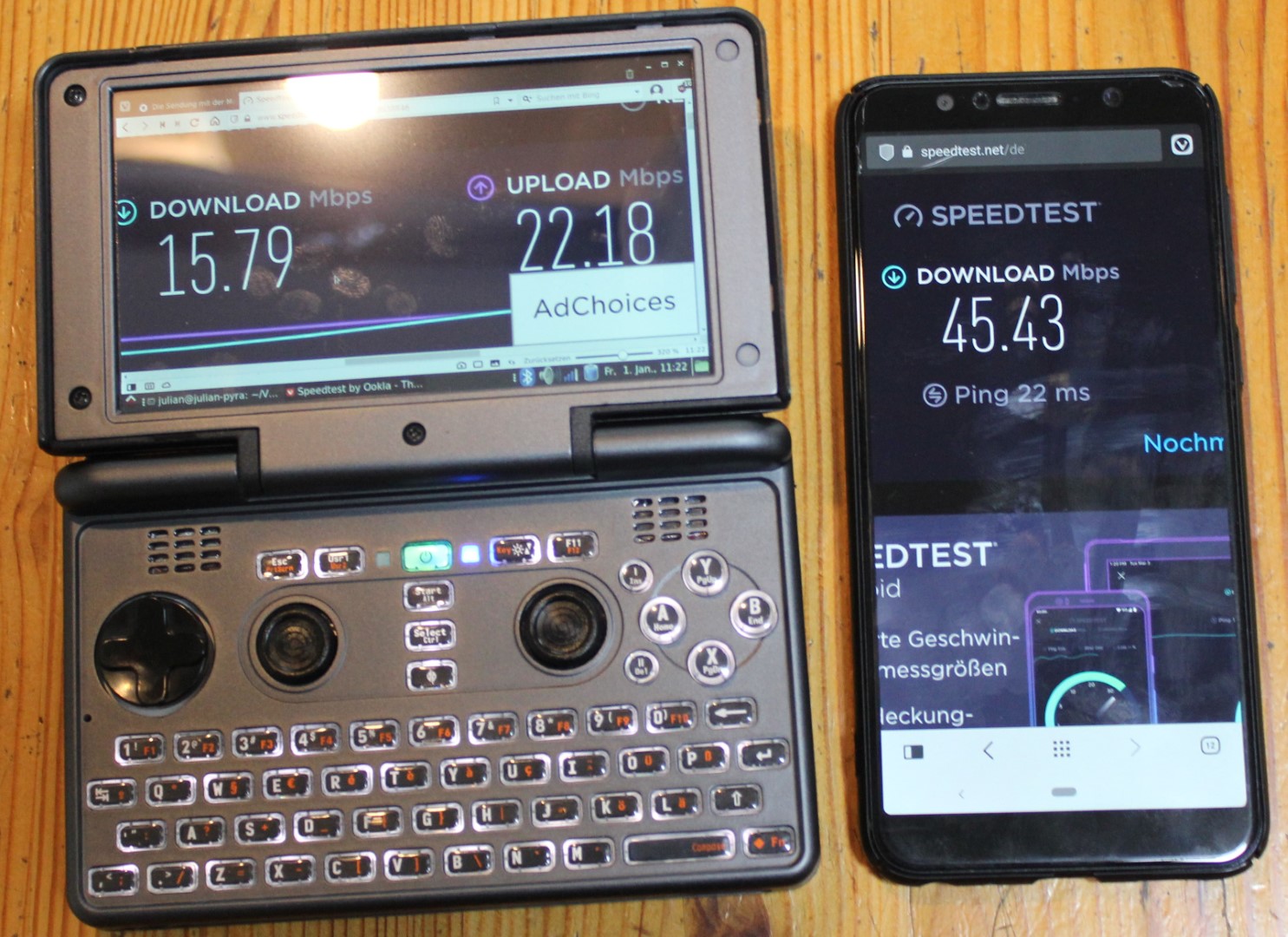

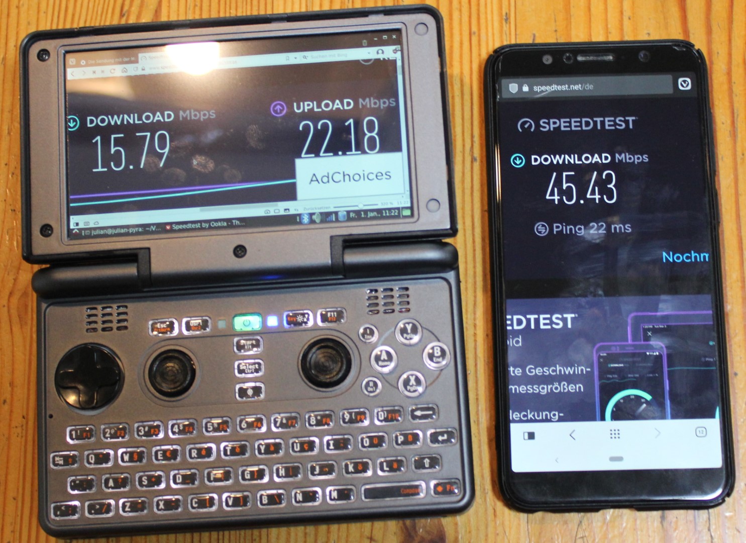

Wireless connectivity is also a problem. The reception (compared with my cheap phone) is bad
even when positioned half a meter away form the access point I was not able to reach more than ~45MBit throughput. Also the device sometimes looses the connection even with that distance. With the Pandora I used a external USB WiFi adapter and I hope I don't have to do that here too. Maybe this can be improved with firmware tweaks or configuration?
