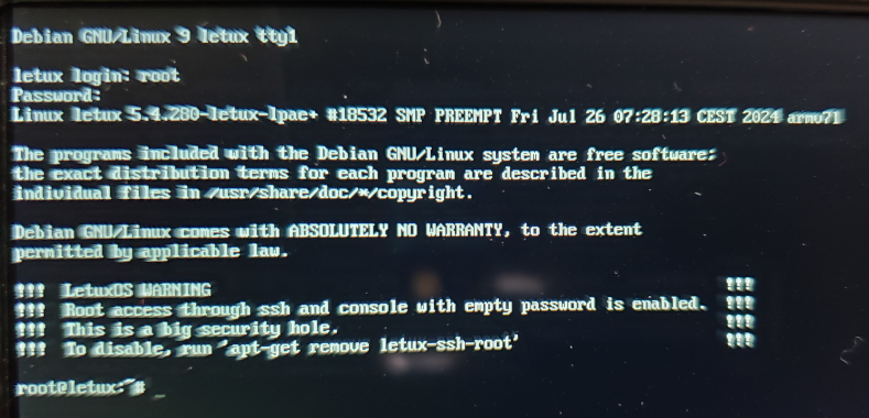

This boots to tty1, but no Fn keys work, so I can't type most symbols. This is what I see:
Askarus, is this how it fails for you and ED?

This is more that what we got. For us, the installer failed. Maybe there was some update within the last few months since we have tried.
It is great news that you were able to get it to boot.
I do not call this a failure.
It most likely does not have funkeymonkey/pyrainput, so it is natural that the fn keys do not work. I guess you need to ssh into t or use an external keyboard.
Can you type "-" (FN+X) if so, you can type underscore via FN+SHIFT+X.

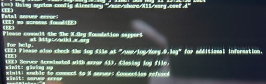

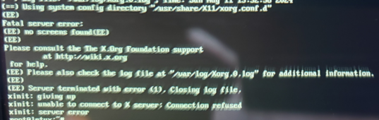

I can't start XFCE using
startxfce4
I foolishly did not check that log before shutting down. :oops:
I can try again later today or tomorrow, now that I've refreshed my SD Card with a fresh LeTux. I'm sure I made a novice mistake or am just missing something important. We'll see!
