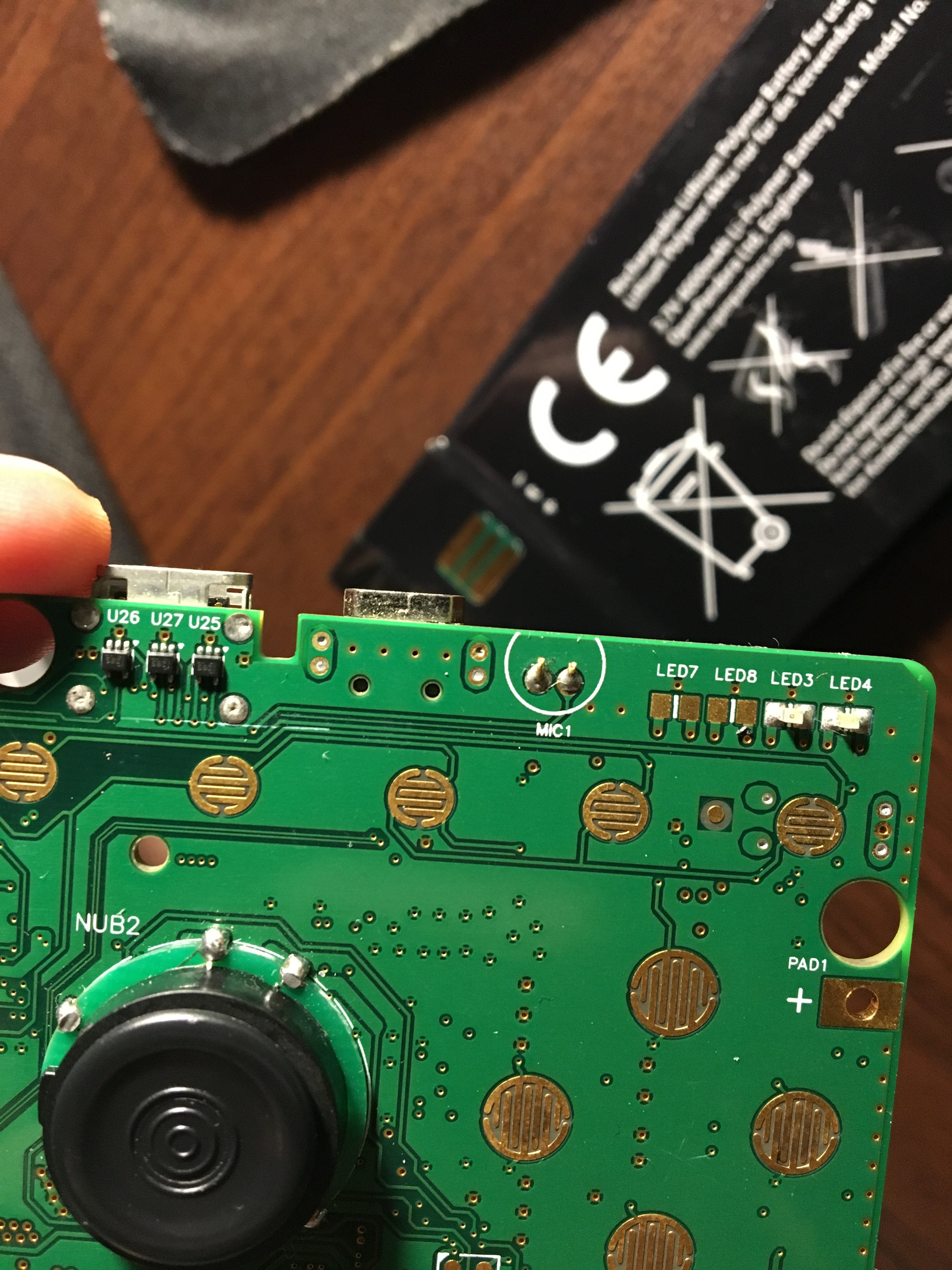

sorry for bothering you. I found that there is something missing on my board on the MIC1 area. What is that for?
Thank you
If I recall correctly the mic can get knocked off by the case during disassembly due to the tight space it is in.
Indeed, although it's not really a lack of space that causes the issue, it's that it's enclosed in a plastic tube to ensure sound is transferred from the outside to the microphone efficiently. If you pull the board off at an angle there's a risk the microphone can be pulled off. It's probably still there in the tube, but probably not repairable having lost most of its legs.
But a missing microphone shouldn't cause the system much trouble, if you're not using it I expect. I guess it's a little piezzoelectric jobbie, which tend to have very high impedences, so an open circuit is electrically rather similar, just somewhat quieter after recording.

Oh, I forgot to mention that the Color of screen is similar to the one that someone mentioned before.
The cable may not be seated perfectly. Even a slight kink in it will cause colours to go funny, the "purple screen of death" as it's called sometimes, though it isn't always purple.
