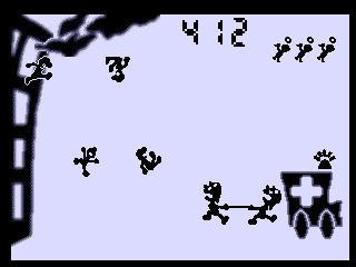

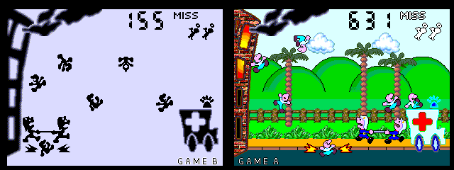

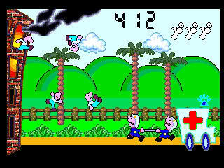

1 building, 1 mission, some little stick figures and an ambulance - which has a light.
It's taken about a month but finally the full game is here, an exclusive & updated version of Fire has arrived on the GP2X.
The Nintendo Game & Watch smash hit Fire has limped onto the GP2X with some serious flames. (Well a bit of smoke actually).
Updated for the GP2X with all new graphics, and a high score table - creating an awesome 80's handheld game which will quite literally make your fingers ache.
It's time for Fire - the reason the GP2X has a delete function.
