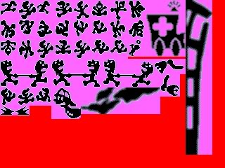

xnopasaranx suggested that there should be an option for a colour version. I like the graphic forms but agree it would be great to have coloured versions of them.
However I am too lazy and not talented enough to do the job justice so would like to know if anyone would enjoy colouring in the existing graphics. In exchange you may feel a sense of satisfaction and your name will be linked to what, possibly, will be the worst home brew game ever released for the GP2X. You will get full credit in the program (unless you would rather not have your name associated with this production, in which case I guarantee total anonymity).
There are a couple of restrictions : It is an 8 bit(256 colour) image and the images must keep their size and position in the bitmap. The choice of pallette is up to you.
In the colour version there is the possibility of adding enhancing background images. Possibly a pavement, street furniture - fire hydrants, pillar boxes etc. Maybe some background image like a city skyline ? So, although this is presented as little more than a colouring job there is scope for you to add your individual artistic mark.
If you do want to do it, just download the image and leave a reply to let me know. Thank you.
BenScar ? WarmFluffyUK ? Anyone ?
I have implemented a list that represents the display. Each item in the list represents an object on the screen and consists of three elements :
  • an on/off indicator - used to indicate if the object is to be displayed
  • the position of the required graphic data in the bmp file
  • the position it appears on screen during the game
It is then just a matter of reading through the list and blitting the data from its position in the bmp file on to the screen if the 'on' indicator for the graphic is set.

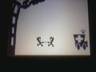

As it now stands I have only managed to get as far as controlling the firemen. But it is running in a loop and flipping the screen and the player can move left and right.

Thank you for your assistance. After reading your post a lot of 'research' was undertaken using the previously mentioned 'emulator'. I can not actually reach 200 points but my flatmate can clock the thing. It plays the version where you get a point every time you 'bounce' a jumper, and he has confirmed the scoring system you report. The 'emulator' uses the the second system.
Progress is slow. I now have the jumpers working, they jump, they bounce, they fall, they get saved, they increase in number and get faster. I count the bounces. An angel appears for each miss and the game stops after three misses. I was feeling pretty chuffed with myself......Until my flatmate tells me that it just all wrong. I have the jumpers jumping and progressing a step on every 'tick' of the game.
He showed me that it just does not work like that. Using a metronome (he is a musician) he established the game to start at about 98bpm - that is to say a jumper moves position on this beat. However each time the player 'bounces' the jumper, the jumper shifts phase by a third of a beat so that a new jumper will not move at the same time the 'bounced' jumper does. The second 'bounce' shifts the phase again so that there can be three movements happening in each beat - a jumper dropping from the window, a jumper who has been bounced once and a jumper who has been bounced twice. The third time the player 'bounces' the jumper (into the ambulance) the phase is back in time with the initial jump.
This really does give the game a lot of its character. It also circumvents the possibility of the player having to bounce two jumpers at the same time (I think ?). It also hurts my head trying to think about how to implement it.
Back to the drawing board I guess.

Daid posted on Sep 28 2006 at 08:32 PM said:
Now, back to Jabber. Any idea when you have something the public can play? :)
I have reimplemented the jumpers to use the 3-phase movement and it now feels much more like the real thing (well more like the emulator I am using).
At the moment it only plays 'GAME A' (i.e. all jumpers start at the third floor).
I find it really difficult to play the emulator and analyze it at the same time so I have not quite got the speeding up sussed or what the conditions are when the number of jumpers increases. I have some arbtrary settings that I will try and adjust as/and when the way the game performs sinks into my dense head.
I even don't really know how it decides when to start a new jumper. There definately seems to be some random element.
I also need to add in the 100 point relief (reduction in jumpers) and the 200/500 point 'clear all misses.
It needs to play by itself when the user is not playing.
Like Pac man, Game & Watch would be a shadow of its self without the crappy sound, so that has to be put in.
The graphics are extremely poor. The jumpers seem to gain or lose several stone every time they move. Also there have been no takers for my generous offer to allow someone to make some colour graphics.
It is hard to believe how such a simple game could involve so much bl**dy work.
