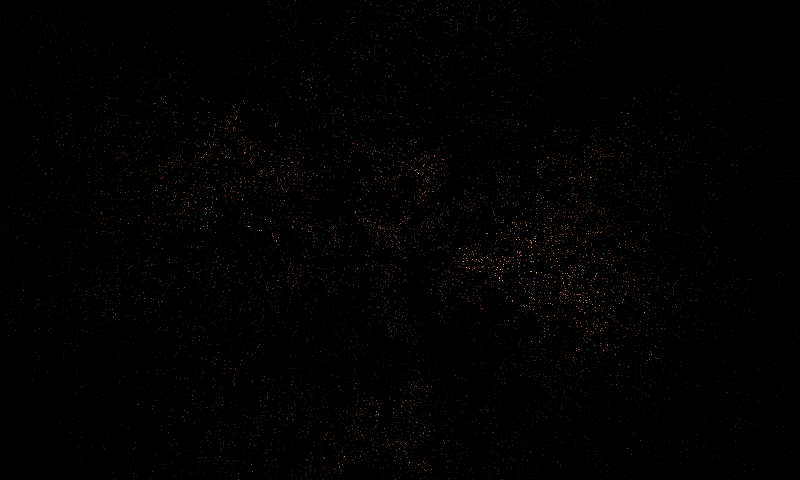

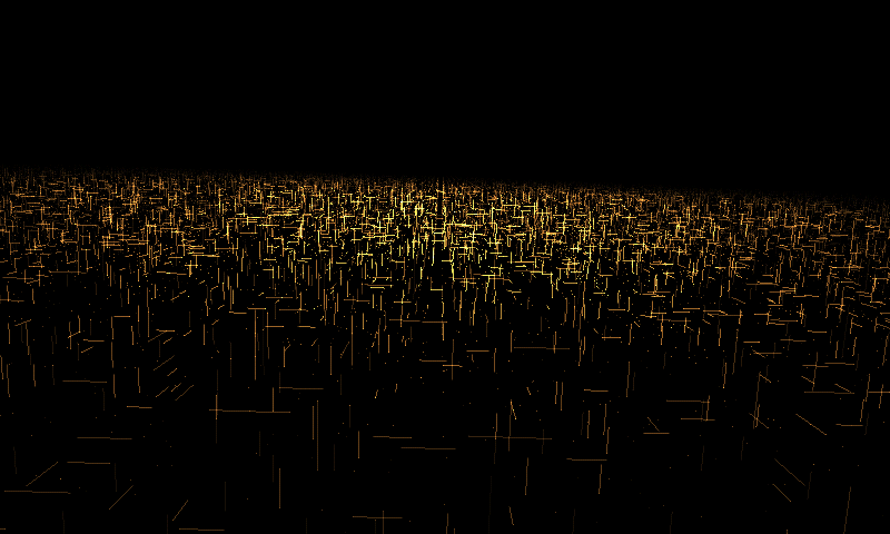

Just in time for the recent discovery from NASA :cool: i release the demo. "Its Full of Stars" by Traction.
This demo was presented at Ifparty 2006 where ranked 2nd.
Links for more info about this demo:
http://www.pouet.net/prod.php?which=24373
Download here.
Visually is really nice, the music (if you could call it music) is a bit strange and maybe boring...as explained in the info
was truncated/reduced to gain space (it is a 64K demo).
On Pandora it run with the help of gl4es by ptitSeb and fps will vary from 3-4 frame to 160fps in some scenes @825Mhz on my CC.
Source is included in PND.
Enjoy.

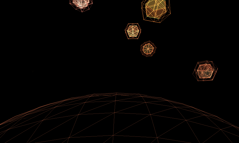

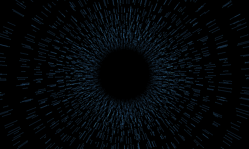

So on the second run I switched deadbeef to use null output, and then it ran with sound. I did find it more tolerable with sound, and as you say some of the effects are quite nice. I think there's one effect early on (second or third scene) that doesn't run properly, or at least it doesn't get very bright before it terminates on my 1GHz Pandora.
it's on this ?
or this ?
