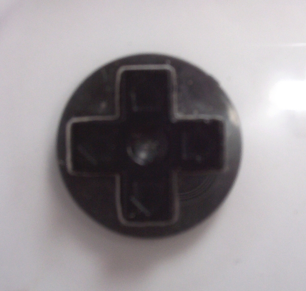

On page 18, I cut out a D-pad using the hole from a NES controller, as the 2mm perspex I am using is clear.

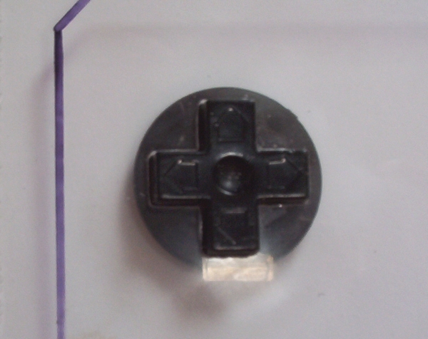

You can do the same thing with the GP2x, but you will need to trace an outline of the D-pad cross you are using (whichever you choose) onto a piece of thin card and stick it in place with clear tape, then cut out the hole using the tools I used.
This might help someone make a clean-cut and accurate D-pad hole in their GP2x, so I thought it worth posting.
This is an easy process.
D-PAD CROSS HOLE MAKING PROCESS
This is the result, the D-pad cross is through my plastic sheet:

No problem. The advantage of this method is that the hole required for just cutting a D-pad cross is smaller than having to cut a circle out, so if you screw up just cutting a cross out, you can always use the circular cutter and complete your project that way!
