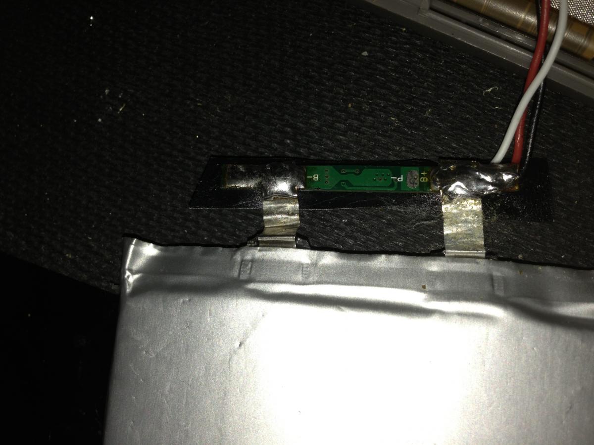

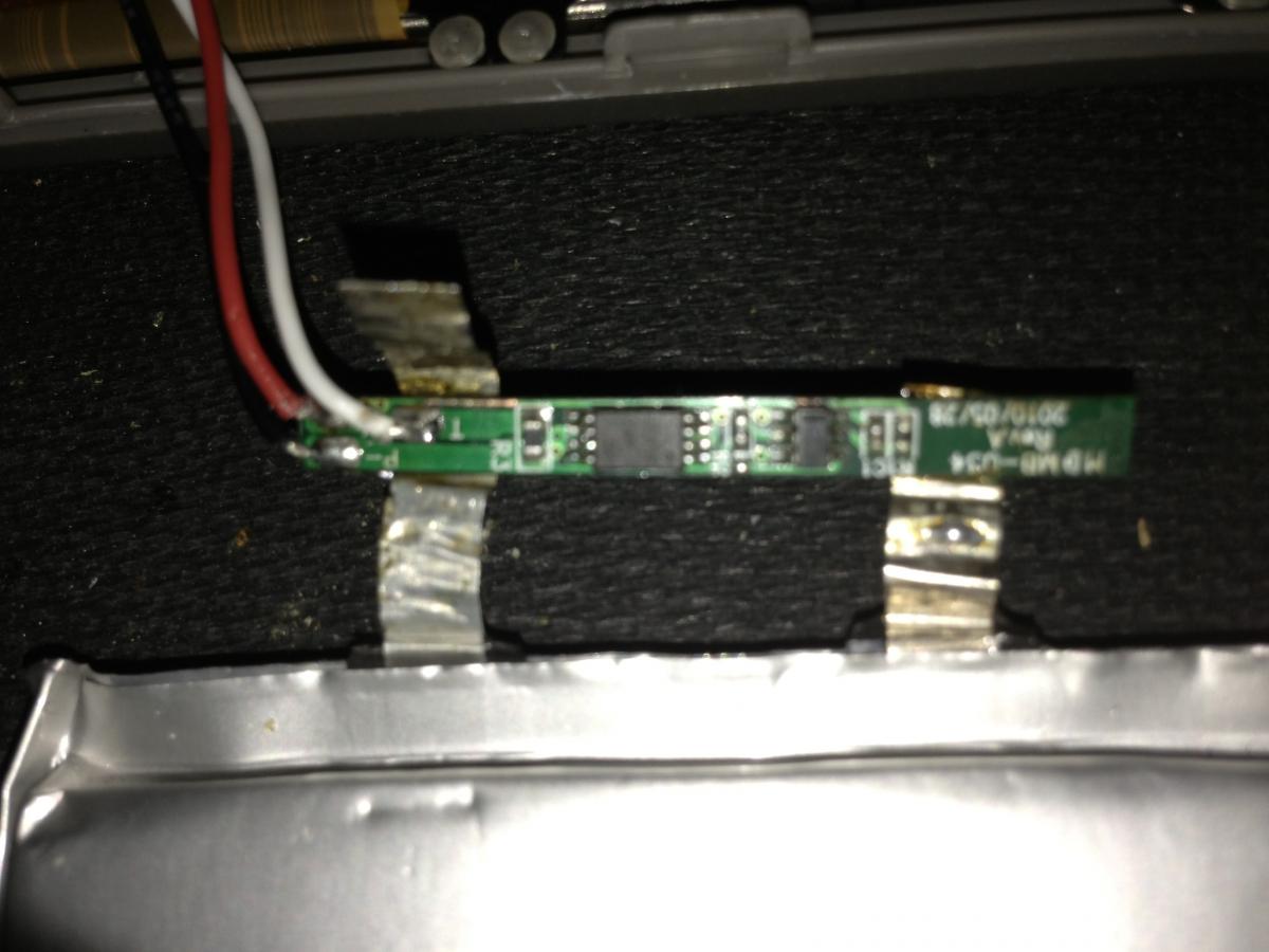

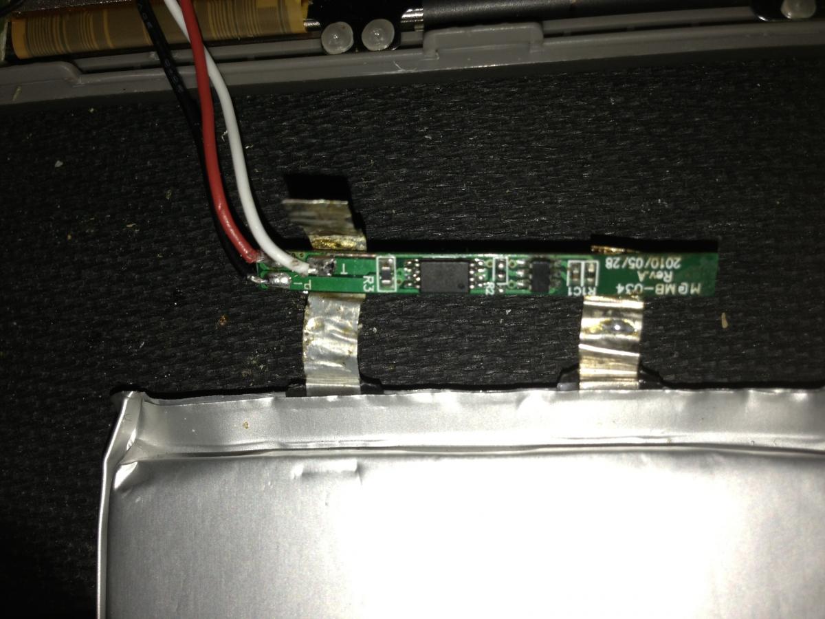

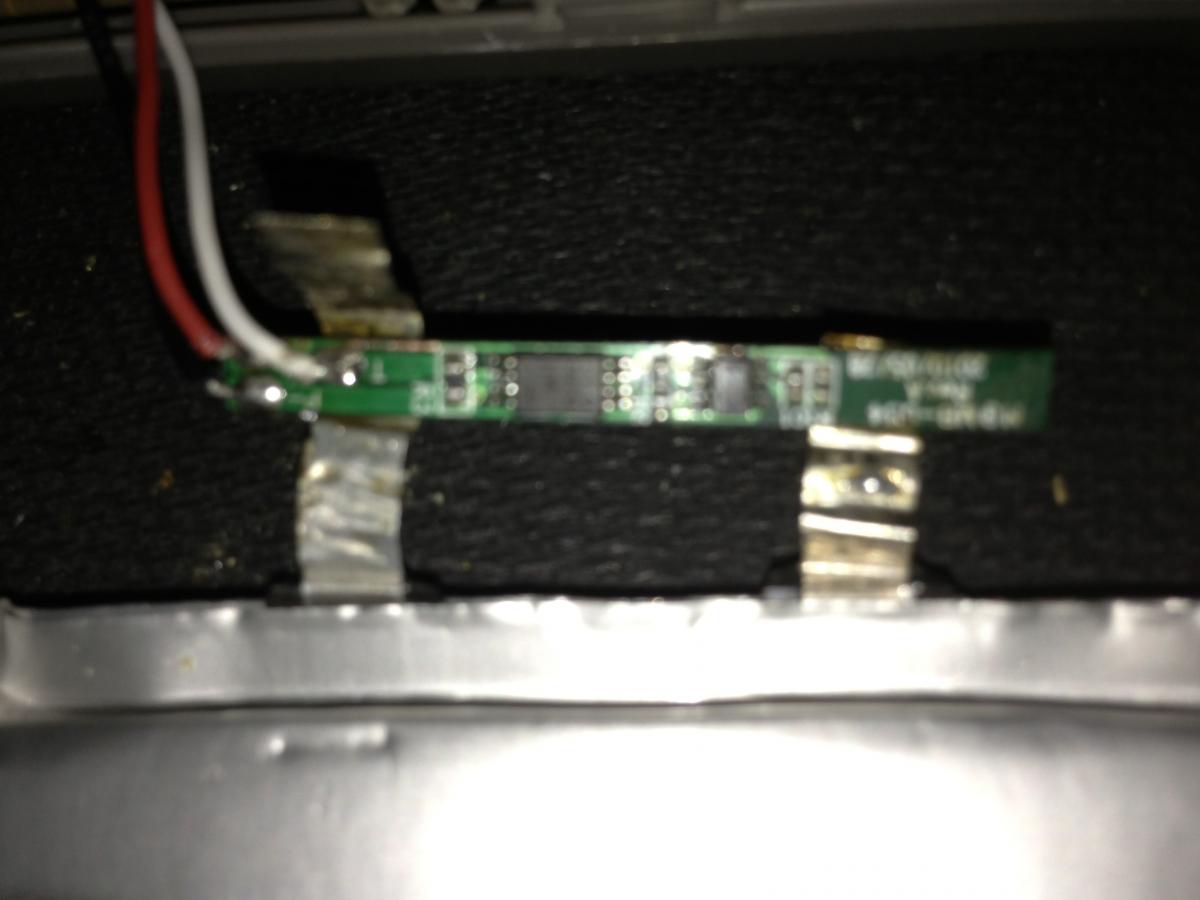

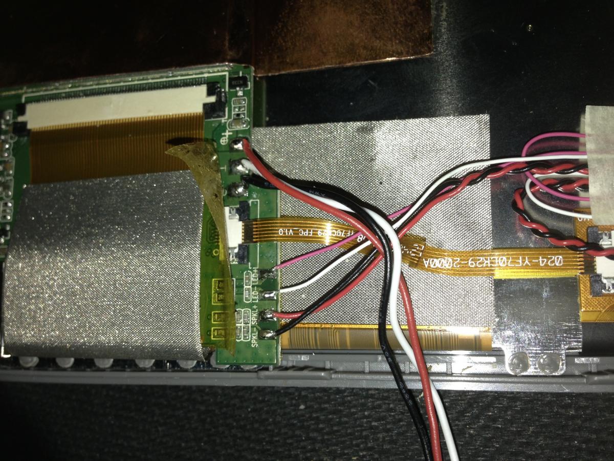

Here are some close up pics it seems like everything is in order just cant figure why its not working.
It sounds like the battery level got to low.  What voltage does the battery read?
Have you tried hooking up the actual charger, not usb ?
I was getting a steady 3.7 - 3.9. What I ended up doing last night is to re-solder all the joints again however now I get nothing via usb I left it charging all night hoping it maybe needed a boost but nothing. I was happy to see it at least boots up now with 10w apple wall charger  (I don't have the adapter for my original UK charger) i'll just fine ill have to leave it charging all day and what happens.
