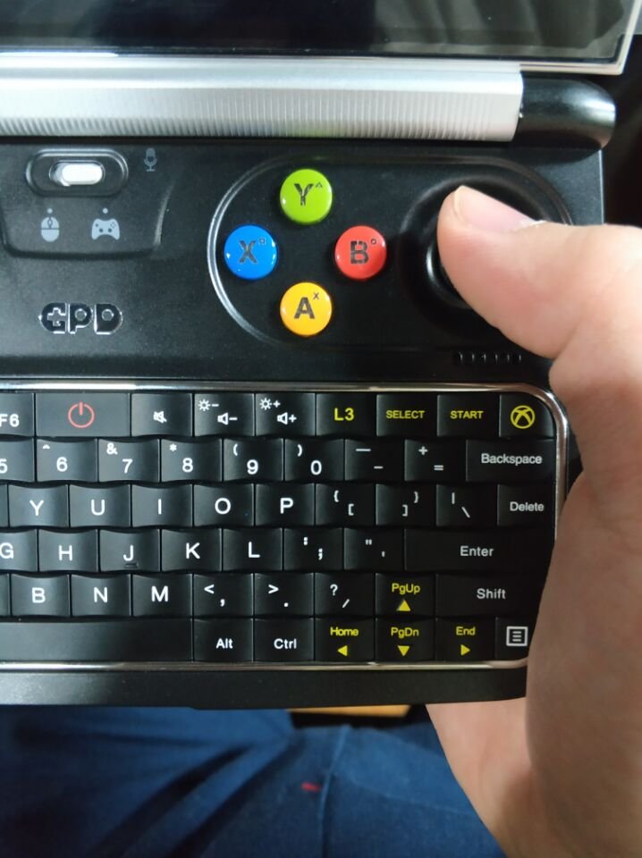

I'm a little concerned seeing how the expanded keyboard has pushed the game controls up towards the hinge that maybe my thumb would foul the hinge when going for the Y game button.

The keys look seriously messed up.
It looks like they are deeply concaved, making flipping between them a very bizarre experience.
I'm pretty sure they're slightly convex. Maybe the sculpting of the key they've done is confusing you - I think they're pincusion shaped - a flat arch left to right that's narrower at its apex than at its edges. The missing bits of the arch are filled in with ramps to square the key off. I guess they've done this so that you can feel they key you're intending to hit under your thumb without being confused by the edges of adjacent keys. A domed key set also acheives this affect, as on Pandora but some people don't like the feeling of domed keys, preferring something flatter and this might be a useful compromise.
