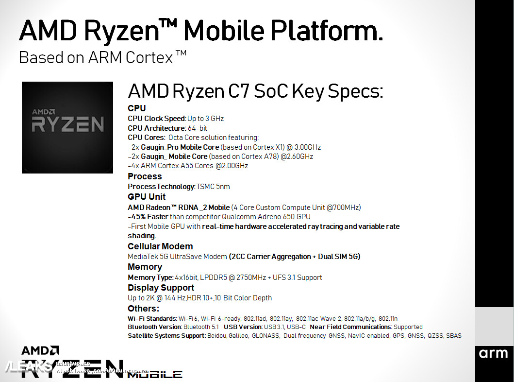

I've just got a strong preference towards open standards - more commulated experience behind it, less licensing fees involved in production (=> hopefully cheaper product), and maybe that mindset grows and we can have it more modular again (opposed to needing a device tree for every fucking device model), and probably more.What’s wrong with ARM? (Genuinely curious)
I don't know much about that field, but could something like that 4k-core processor Esperanto is working on be used for graphics (with a more complex software stack, maybe)? (Not for the Pyra, but for a silver lining.)That would me my preferred choice, too. AMD is nice driver and performance wise recently, but as already stated, it has a big package and 6W is already a lot.
