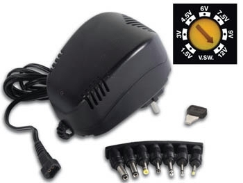

what do you think of these 2 adapters?
Stabilized
230V AC/1.5 - 3 - 4.5 - 6 - 7.5 - 9 - 12V DC.
Max. output:
1400mA. do 6V
1100mA při 7.5 a 9V
1000mA při 12V
Power 12VA.
Short circuit and overload protection.
Connectors 2.5, 3.5mm, 2.35x0.75mm, 3.5x1.35mm, 4.0x1.7mm, 5.5x2.1mm, 5.5x2.5mm .
Price cca 10€

The first one should be ok. I run my 2x off 3V all the time without problems, but some adaptors can be fussy and not work properly for some reason. Some people even run there 2x at 4.5V (eg. Reesy).
I suppose it all depends on how much care and love you want to give your gp2x :) Some people prefer to spend the extra, some not..
