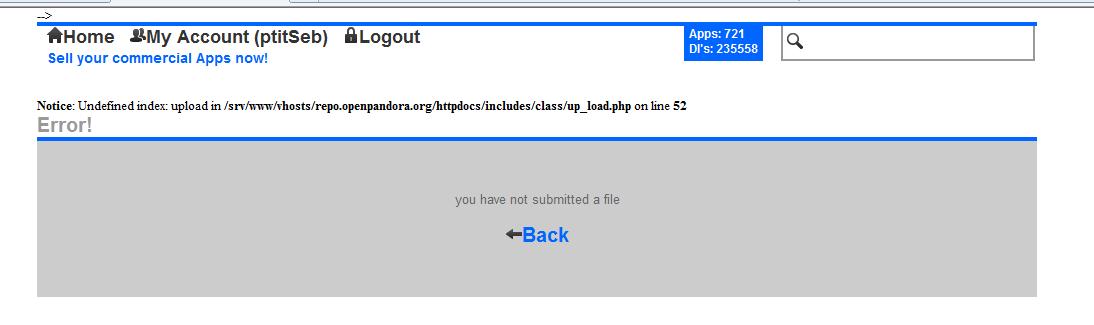

I want to upload next build of CodeBlocks PND, the build 08, but  can't. Size is big, it's now 660Mo (and build 09 will probably be bigger).
When the upload finish, I have this: "Notice: Undefined index: upload in /srv/www/vhosts/repo.openpandora.org/httpdocs/includes/class/up_load.php on line 52
Error!"
Here is a snapshot: error_upload.png
What can I do?

Nope, same error  :(  . Is there a timeout ? Is the parameter taken in real time ? Nothing to restart ?
*EDIT*, Also, I had to re-loggin after the error, so maybe it is a sign of something ?
