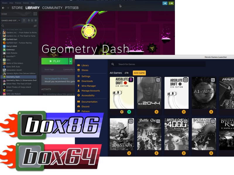

New version of Box86 and Box64 tagged!
More details on
And on the github of both boxes.
And phoronix also covered the release: https://www.phoronix.com/news/Box64-0.2-Box86-0.2.8
(I also created a small blog entry https://box86.org/2022/11/box86-v0-2-8-box64-v0-2-0/ )
