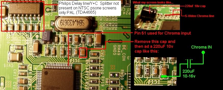

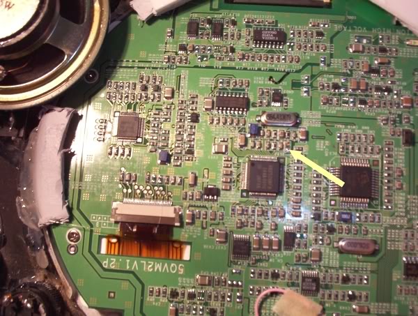

Using the instructions from sam_thornley's post, http://forums.benheck.com/viewtopic.php?t=20158 I did his mod to make the PSone screen (PAL) take s-video directly.
The below two pics are sam_thornley's from his posting, all credit to him for these:

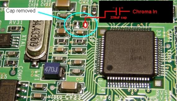

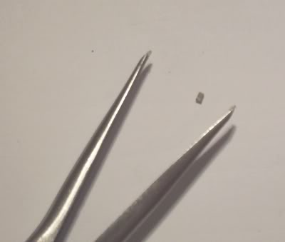

I had to use my dremel to make the ends of my slim pliers thinner, so they could grip the component so I could remove it after using a hot soldering iron. (in pic is the part removed - tiny!).
Removed, came from here:

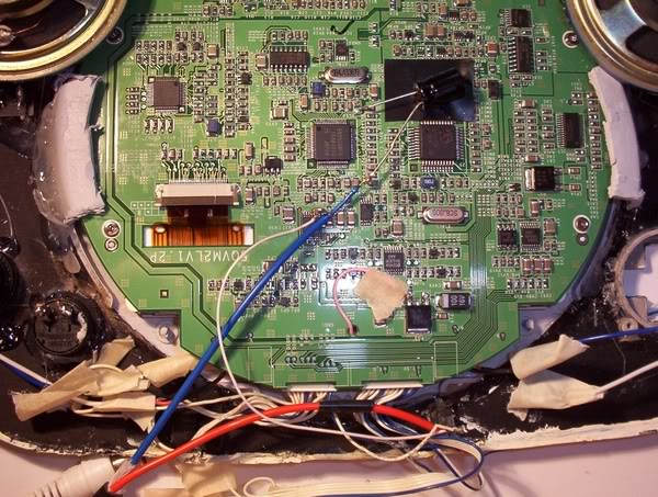

Wired up the capacitor, put a piece of electrical tape under where the capacitor was going to sit and put a blob of hot glue under capacitor to secure it in place.
I am using the PSone screen from my old BigBoy Advance project, once I a ready I will remove it from the casing (and bin the old case). Rather than destroy the GP2x tv-out cable, I cut an old s-video cable and used its cabling.
I hooked up the PSone screen to the PSone mains power; connected both the (Y) Luminance ground (red wire) and the © Chroma ground (blue wire) to the ground on the PSone screen and the Luminance wire to the Composite in on the PSone screen.

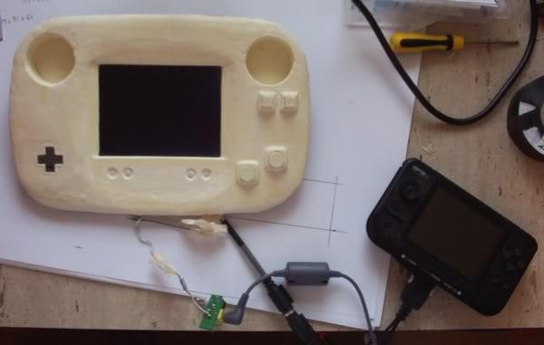

Test rig: GP2x, PSone screen

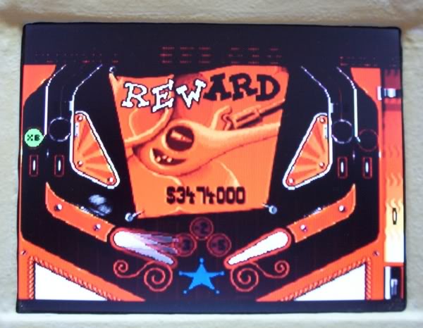

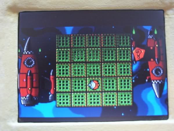

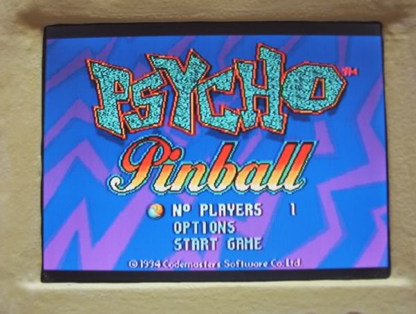

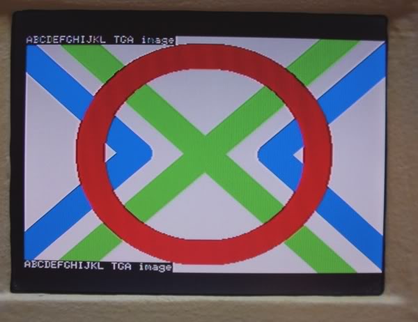

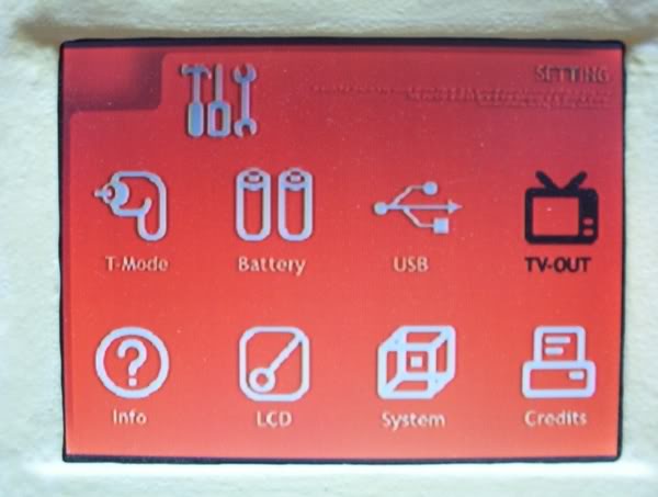

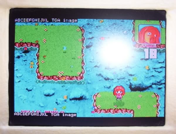

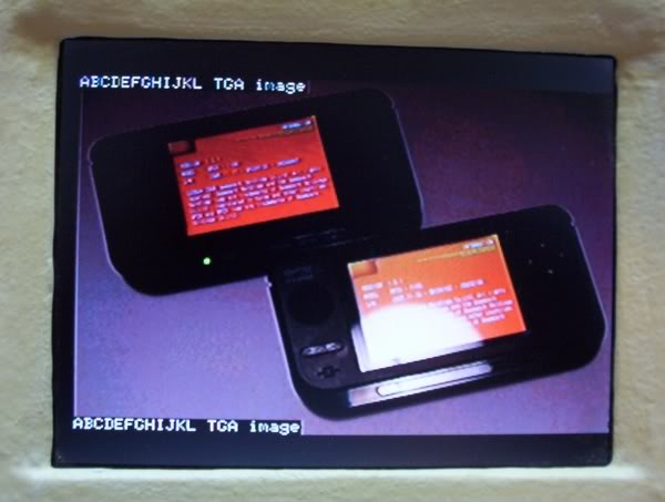

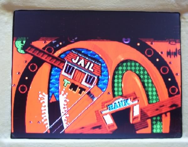

Screen samples below - a bit better than composite, a definite improvement (eg lettering is better, colours a bit better); however there is a slight flicker, just slight - can this be resolved with a higher capacitor rating than 220uf?? Any ideas? It isn't a problem, it would be nice to have a nice 100% static screen.
(Psycho Pinball, via MegaDrive emulator):
Test screens:
Test screens:
