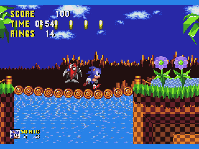

The Pandora has slight ghosting on some games, the worst game I know of is Sonic 1 (those green tress ghost).
A game without any ghosting would be Sonic and Knuckles.
It's down to the bright palette clash (especially bright green) and using that checkboard effect to gain more colours (LCDs don't like that effect at all).
If you can adjust the green down a bit it would probably do wonders.
Hm, I've played alot Sonic 1 onto the GP2X (F100) and never noticed any ghosting. Does the Pandora LCD has a slower response Time than the GP2X Screen or is it all just because of the higher Res of the Pandora Screen?

Like I said, if the turned off sub pixels are only increased by a value of just 1 or 2 in the RBG colour space, The picture will look very much unchanged, but ghosting would be reduced a LOT because the sub pixels are always 'on' and don't go through the slow process of turning on and off. :) Really, the difference in contrast would be as minimal as possible, since you are only turning on any sub pixels that are off by the tiniest amount. I'll make a comparison screenshot of Sonic 1 to give an example.
Alright here you go. An increase of 2 looked pretty much identical. I don't think it would help ghosting much either :P
So I increased any sub pixels that are below 40, to 40. Except for blacks and near blacks, I raised those to 16.
Unaltered:
Altered:
Doesn't look too bad!
Would you have been able to tell the difference if it weren't shown side by side? And this is for the worst offending game of ghosting, right? :P So the differences would be even less for other games.
