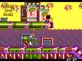

Just a small progress report to show this is not dead (going slow due to pandora firmware work that is also going on). I've finished most opcodes in the recompiler (lots of boring coding there), even without block linking or register allocation there is ~2x improvement already:

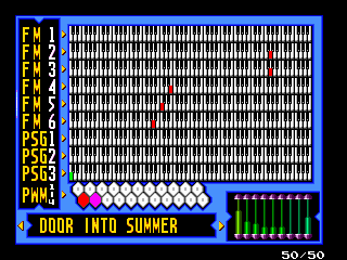

Sound test in Chaotix reaches fullspeed in PAL mode with 32x layer disabled (still testing on GP2X@250Mhz due to convenience):
One of SH2s is used to play some instruments here.

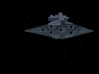

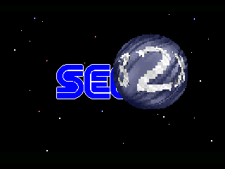

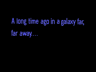

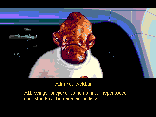

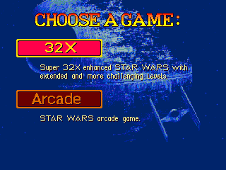

Any chance of a Star Wars screen shot? :D
Unfortunately only from the intro. All shots from the GP2x.
With the Wiz I managed once to go in game with quite nice framerates but without enemies.
At the selection screen you get steady 60 fps and brilliant John Willams sound with the Wiz overclocked to 600MHz ...
More to come...

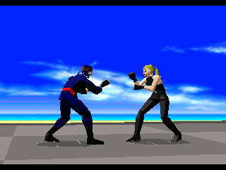

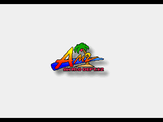

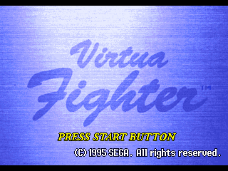

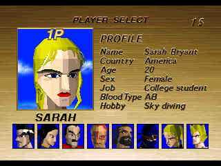

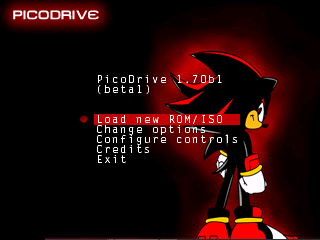

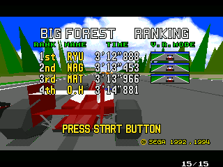

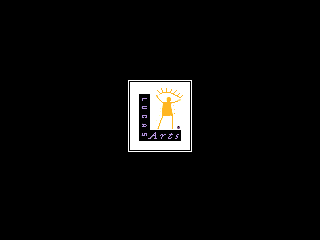

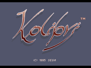

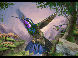

Some more impressions: (Notaz asked me to make some videos, but my equipment here is not the best. I'm working on it...)
The 32x support is in a preliminary state. Not much playable yet except some levels of Chaotix. PicoDrive often stalls and crashes when going in-game.
But a lot of intros and options screens a already fullspeed with 22KHz PWM sound on a Wiz at 600 MHz.
Sega Master System support is another new feature. I only tested Choplifter (US) which run great at 150 MHz, 44KHz sound and anti tearing fullspeed with sound.

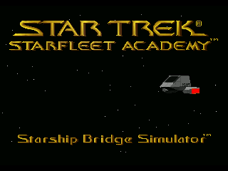

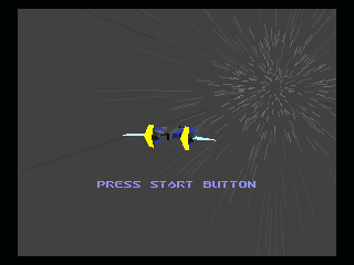

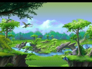

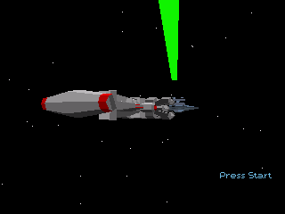

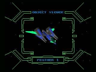

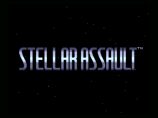

OK, here's the rest:
Stellar Assault runs fluid at the intro and in the options screen, showing some 3D objects. Very promising...
