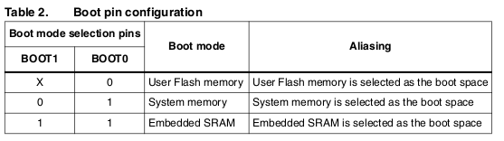

Yeah, fully agreed; its something I've been mulling over.. ie: some sort of dipswitch to configure BOOT0 or not, or just tie it down. In experimenting so far, its not been needed at all, but when going to print pcbs I wouldn't rely on that 'luck'; best to 10K tie it down, and I think anything else is unnecessary.
I also need to look into the flashing via serial; I'm planning on using usart1 and usart6 (the higher bandwidth ones) but still need to verify those will work with the timers and setup already planning to use for the vga generation.. but be nice if flashing via serial worked as well, to save people getting a programmer; or maybe worry about it later.

edit: Added the pull-down for Boot0, instead of a switch; if anyone needs to fiddle with boot0 and boot1, they can use the BoB header easily enough, but I dont' anticipating fiddling with it much myself (and therefore I'll definately need to, .. ahh Murphy
