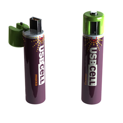

I've yet to see a battery powered USB hub.
They do exist, though. Unfortunately, the only ones I ever found took AAA batteries but I don't want to get rechargables of yet another battery type. If anybody sees an AA powered hub around, send me a PM! Of course, every AAA hub could be modded to take AAs.
why don't ya buy a pack of usbcells? :lol: they came in various formats.. 9v as well
www.usbcell.com
AA
AAA
ps. ain't no spam! lotsa people here like geeky gadgets eh? :)
Because I've got about 20 AA rechargeables already and capacity is more important to me than being able to charge via USB. When I charge them it'll mostly be from mains. They are then used to power mobile devices, mobile USB etc. so it would make more sense to get them with USB sockets, not plugs. Guess they aren't available with sockets, though, are they? :ph34r:
