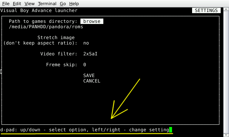

Sorry, but how do I change filters? As a matter of fact, how do I edit any of the settings?

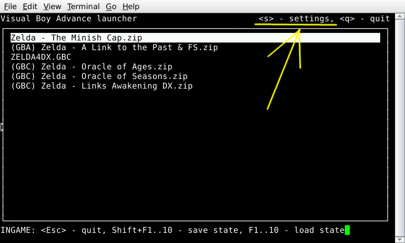

Just type "s" for settings as it's stated in the right upper corner of the launcher...
Left shoulder button and "s" brings up the settings menu, you can change the filters on there too.

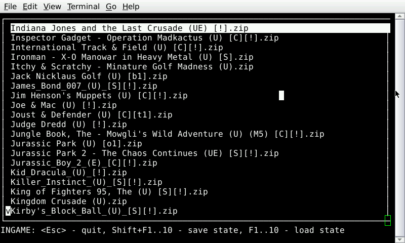

Oh how interesting. Well, It seems I am *not* blind, but my Pandora is... either that or I've found a bug. See here:

Ah. Now that I can change settings it works a treat! Nice filters. ... I don't suppose there is any way to add a filter or colour scheme to mimic the green/yellow tint of the original Game Boys? I really miss this...
Oh for real... It seems that Python detects one line and column more than the screen really has on your Pandora. I have no idea why that could be (but will try to fix it).

Is there a way to get proportional scaling? Or simple 2x/3x scaling?
Yes. In the settings set "Stretch image" option to "no".
