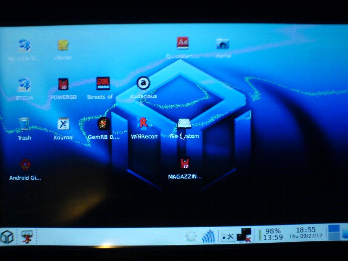

See that strange curved lines in the attached picture... them changes a bit if I move the display.

EDIT: now the display is normal... but I see a flash of the vertical lines if I move it

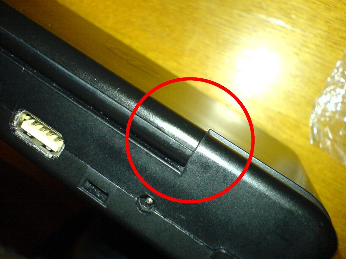

The hot spot was that in the picture, I touched it when closing the display and it was very strange, I nevel felt it this way... The burn smell was coming from there also, but after I shut it down it stopped... anyway I can't see nothing strange, or burned from the exterior

when I fully open the lid, the display changes some colors, but if I slap (in a gentle way) the lid in the right top corner, the colors returns fine !! After trying to move the lid in different directions I found that the problem seems indeed located in the point that I found hot the first time the display died http://boards.openpa...ad/#entry188420
The lid is attached to the unit in a different way there, and when I opened the unit I have seen what seemed a metal pin in that point... Is it possible that it can cause a short circuit if the plastic around the LCD cable is consumed ? Or maybe if the plastic is consumed BY the friction with that pin itself ?
EDIT: Looking better at the ED video seems unlikely that something can touch that pin...
