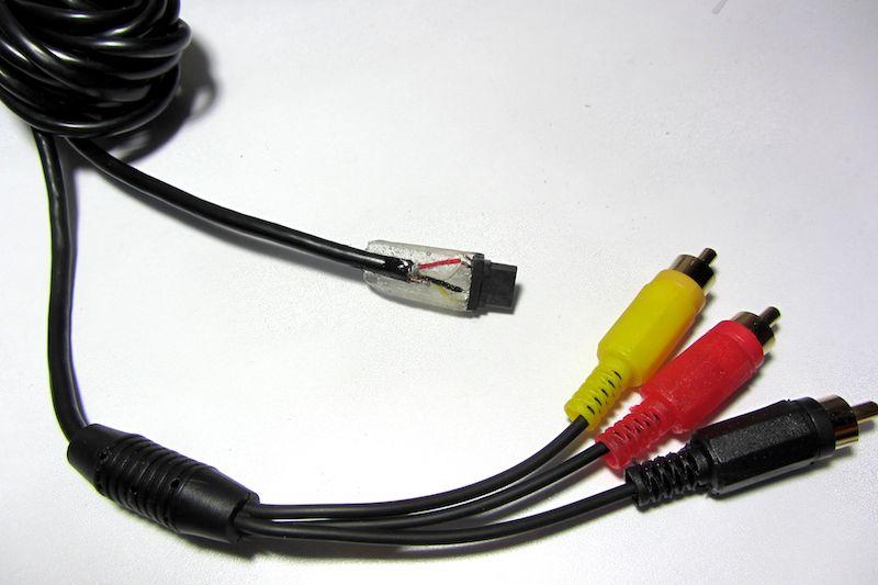

since a customer of mine wanted a TV-Out cable, I made an entire batch (6 pcs).

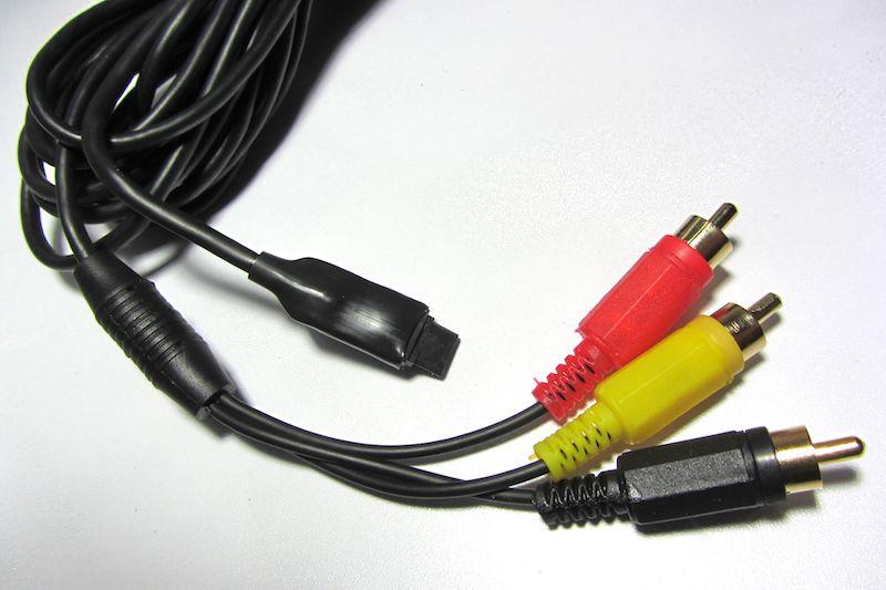

Length: abt. 5 meters
Connectors: Pandora EXT connector on one side (of course), 3x RCA plugs (="Cinch" in Europe)
Mode: Only Composite, no S-Video

This is the cable I used as a basis for the TV-Out cables.
I cut off all plugs, cut that 10m cable in the middle, and made two 5m TV-out cables from one of those.

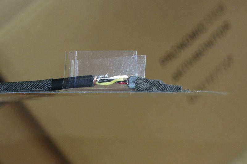

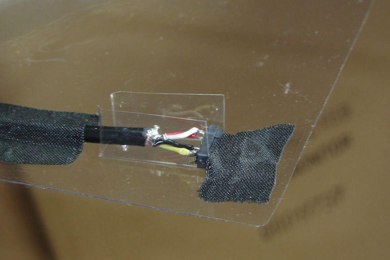

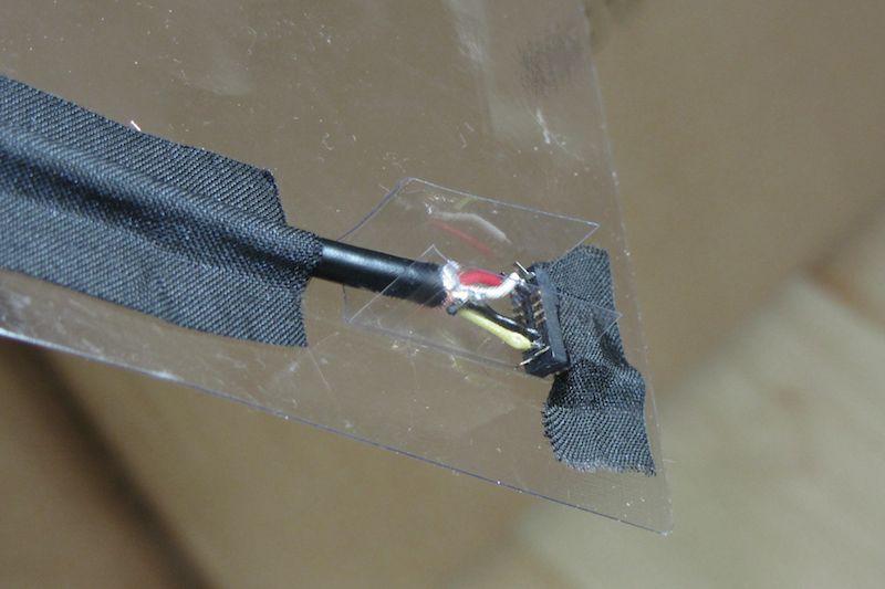

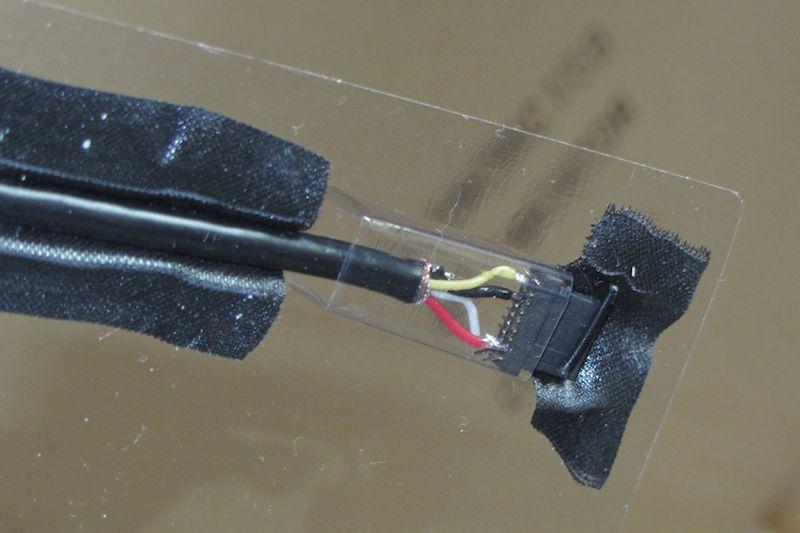

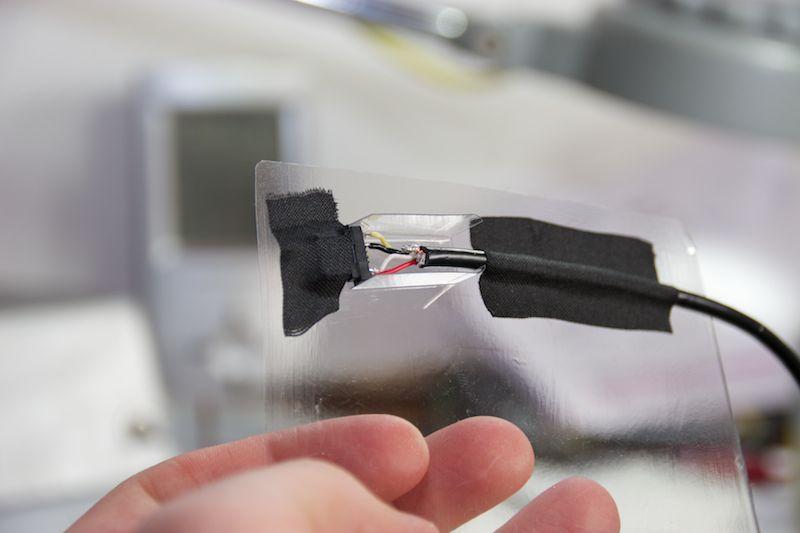

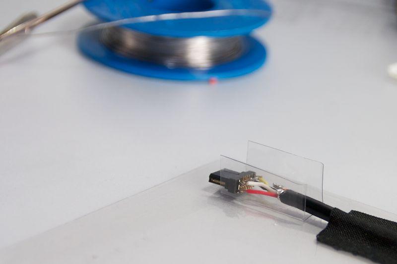

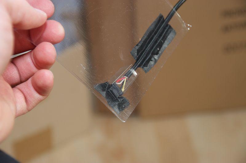

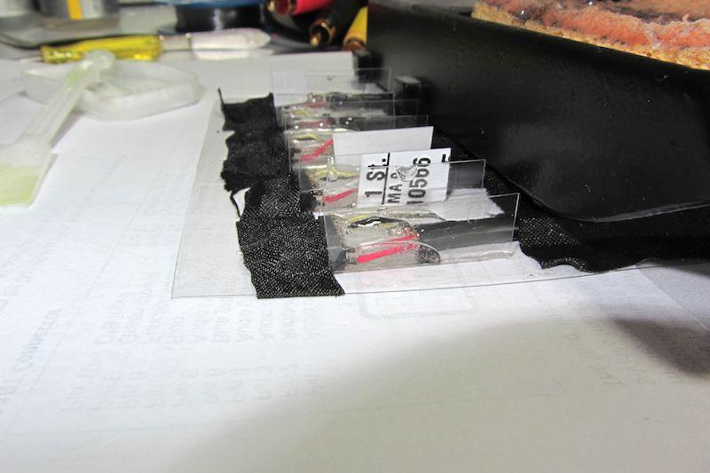

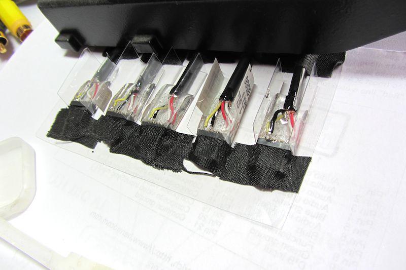

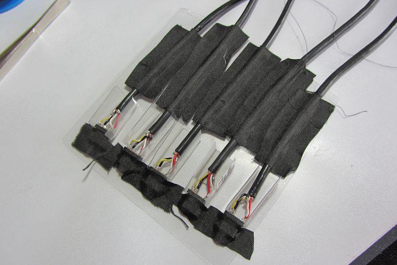

Here are some images, because last time I was asked a few times, how I make those molded plugs. These pictures should explain it. The transparent plastic is taken from some packaging of an electronic item. It's thin enough to be bent and folded easily.
