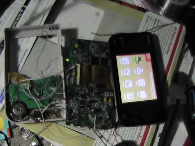

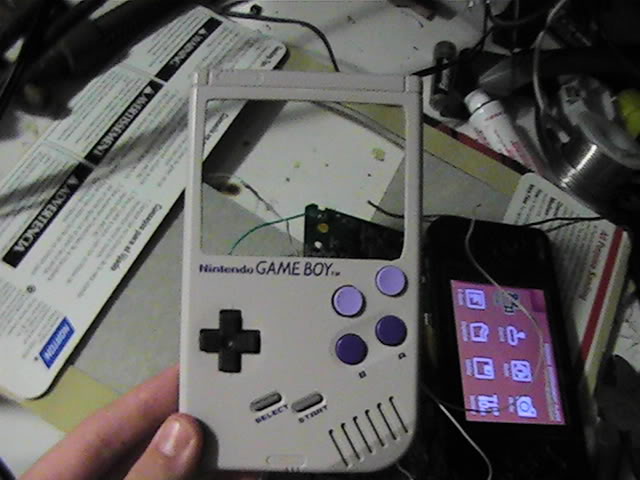

So I wanted to do the dpad mod a few months ago. I to make a long story short, it failed, causing my gp2x to not work, me throwing it in a box for a few months, and a general great gnashing of teeth. Yesterday, I had an idea for a weekend summer project: Try to fix my gp2x. To make another long story short again, I made it work again, and there was dancing and great tears of joy. But then, I realized something... The dpad hole on the front gp2x face plate was missing! Apparently, it got thrown out due to its mangled look.
Now, for a while now I have been trying to transplant a gba sp into a gbo. Unfortunately, I fried TWO gba sp motherboards doing it (Stupid freaky reversed 4 pole gba sp switch!). I then realized that before me lay the perfect new home for my gp2x! I quickly grabbed my tools, and went to work. Note that this is still a work in progress, and is not even close to done. Behold, the fruits of my labour!
All the controls on the front plate work! I forgot to take a picture of t-mode, though. Any thoughts? Suggestions? Anybody know what I should do with all the extra space? Please tell me! And thus I leave you to discuss...
Your goal seems a bit vague, But i`m assuming you are going to at least try to re-locate your GP2x`s gut's in to an original GameBoy case ?. Hey, Call me Einstein. :p
If i am correct and that is your goal, Have you thought about where you are going to place the GP2x`s screen, As that hole seems rather square and doesn`t seem quite large enough to accommodate a 3.5 inch screen.
Another location for something i`m not sure you may have thought about, Shoulder buttons ?. Where would you plan on putting those, Obviously in a place that is comfortable, I would have thought ?.
Oh, Another thing, Is the GameBoy case large enough to accommodate the GP2x`s motherboard ?, I don`t own a GP2x anymore and don`t have an original GameBoy to hand, So am unable to compare.
I seems a great idea, I`m just curious about the possibility of the three points i made above.
If that is what plan to do and you do pull it off, I would love to see the final results.
Trooper
Wow, I was vague... Yes, I plan on putting the GP2X in the GBO case. The shoulder buttons are on the back. I don't want them to stick out, so I recessed them in the screwpost holes on the back of the GBO case. Actually, the hole I cut is JUST big enough to fit, with the screen in it, there are no black borders, it perfectly fills the whole thing. I measured it. :D And to gp2x mobo is small enough, a tight fit length wise, but I can manage. In fact, I can fit almost the whole thing into the top half of the GBO! This leaves the almost the entire bottom half empty. I am wondering whether I should fill it with batteries... BTW, I would love to get feedback from Bacteria, he is the only here who has done super extensive case modding to the gp2x.
