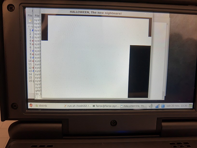

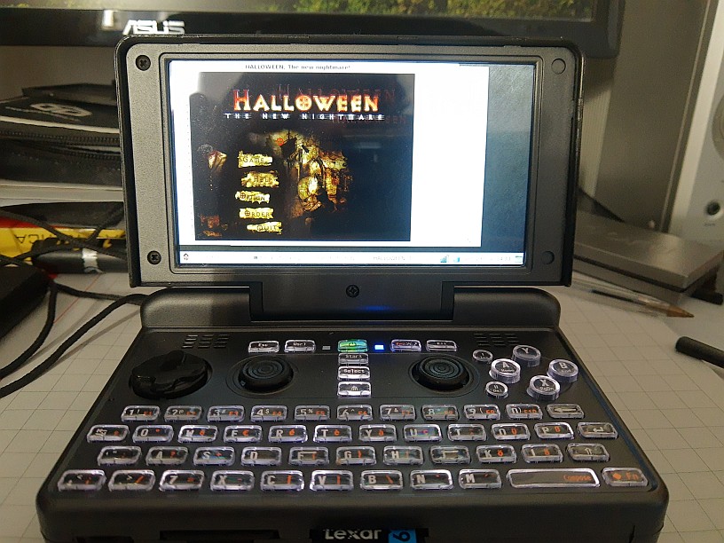

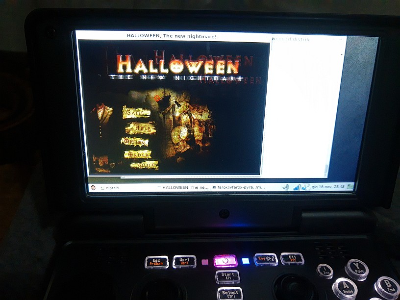

No...on my linux box i can change every resolution without a crash (16 and 32 bit), but instead on my machine it seems not to register the keys (and yes i try to change it on the options menu), also it seems not to work save the screenshot (with numpad 5).
Anyway i built a test with my Pyra...
But i have problem with the texture using GL4ES on it maybe @ptitSeb could help here...i'm pretty new on the pyra.
It run using Mesa with pretty low fps at 800*600 windowed (around 6 fps..)...using gl4es i think we could reach a good fps.
Next i want to try a version for Pandora.

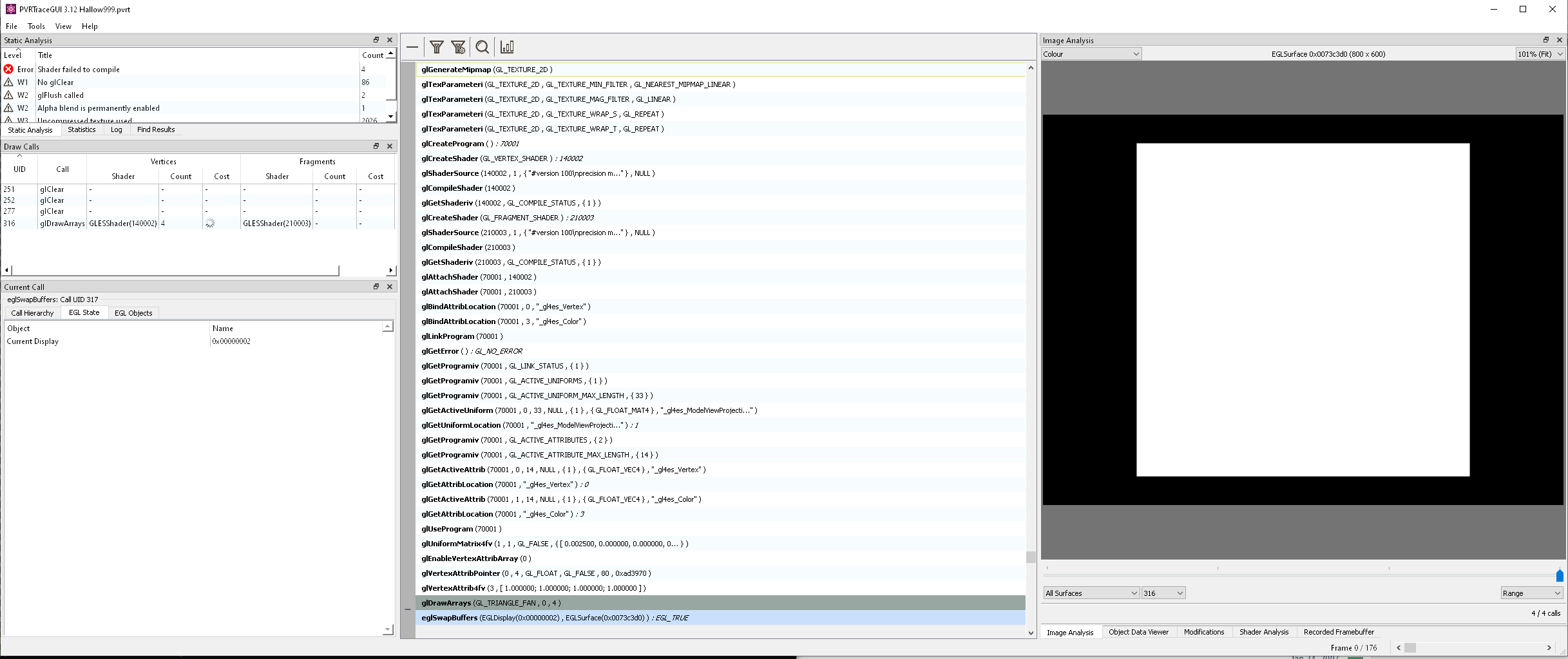

Ok, so I built the game on my side and I reproduce the issue. I have made a PVRTrace capture so I can debug
Something strange here. it's the first logo screen (I guess, I only see white). I can see two texture beeing created correctly, and than a 3rd one is created, left empty, and is used to display the white square...

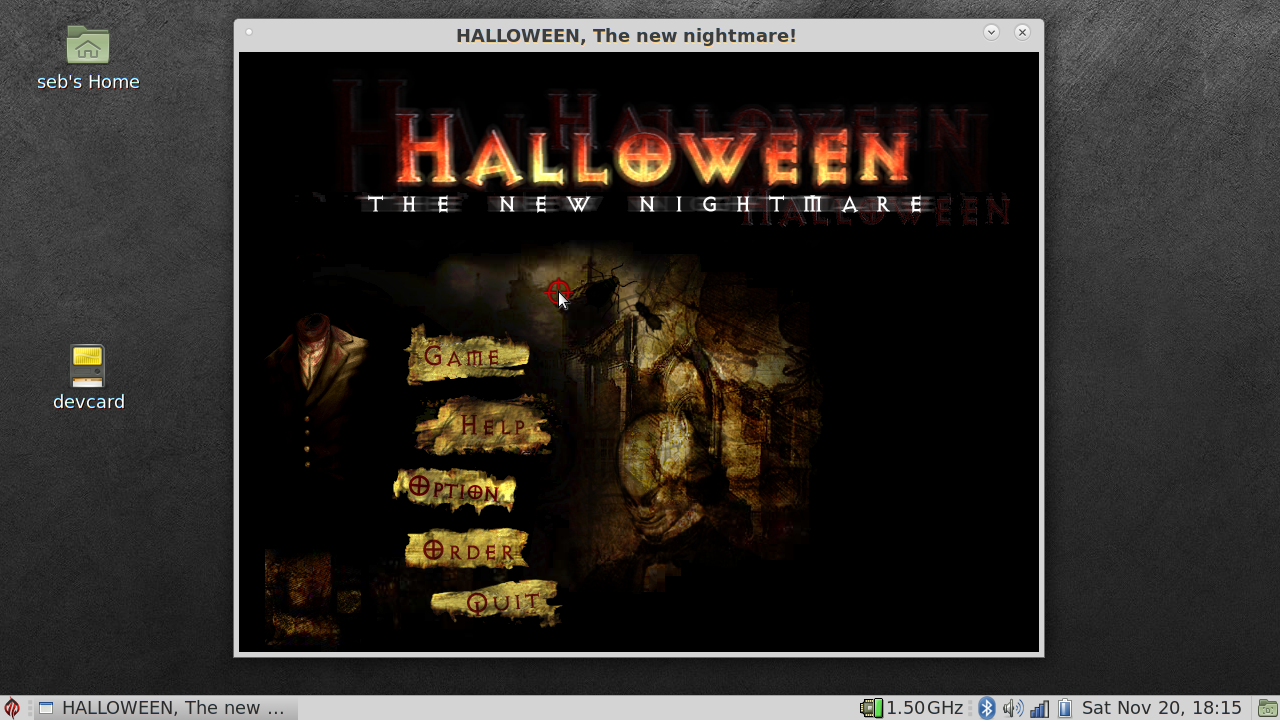

Ok, so I found the issue.
tl;dr:
Comment this line https://github.com/brizzly/Halloween3D/blob/master/HalloweenSrc/opengl.cpp#L1040 and update gl4es to latest version.
long version:
The game use glGenTextures is a strange way. It use predefined Textures ID, and try to use glGenTextures to create those ID. But it's not working like that! glGenTextures is used to get textures ID that are guarantied to be unique, but there is no garanties that the 1st will be "1" or any other assumption.
Software MESA gives you 1, 2, 3... for the firsts textures, so it works. But PVR will gives you 700001, 140002.... And so that's why texture were black. Because the texture is loaded in ID "700001", and than the ID "1" is drawn on screen.
So just don't use glGenTextures(...) and simply use the ID that the game wants. It's perfectly legal OpenGL code (even if not recommanded)...
But I did notice an issue with gl4es on texture not create with glGenTextures. You need to use LIBGL_MIPMAP=3 on older gl4es version to have it displayed correctly if you don't update gl4es...
Thanks
