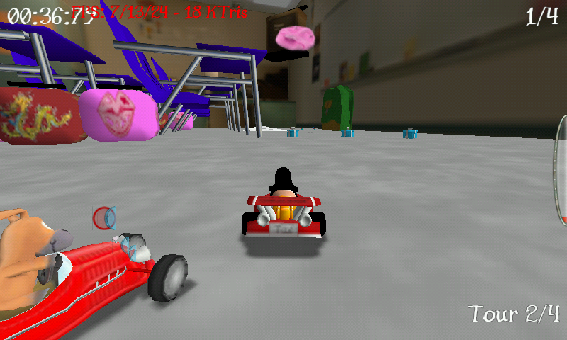

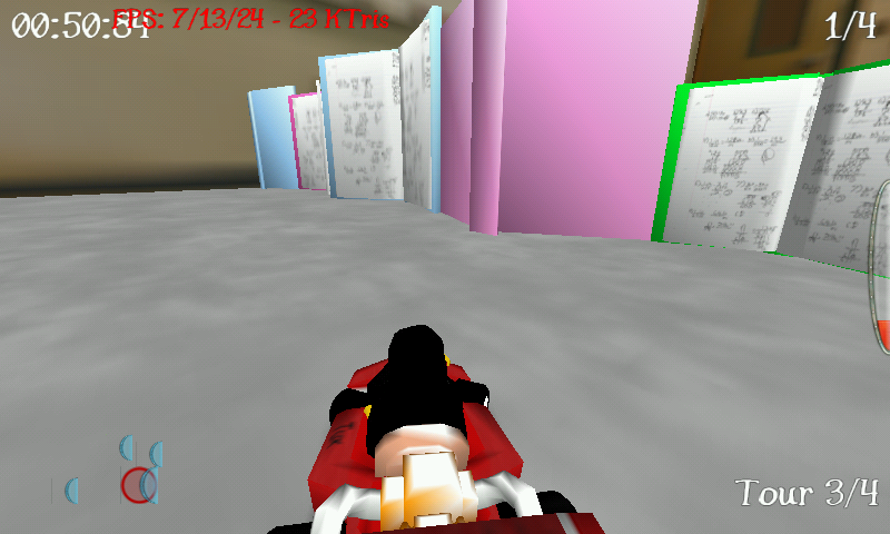

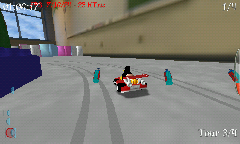

Note that you can select the grpahics level in more detail - either in the GUI, or look at the config.xml file.Ok, previous test was running with level detail of "3". I have reduced the level to "1" (no more animation), and I have better framerate. Betwen 20 and 30 fps on the same track !
*EDIT*, I was playing at "4", and now I tried "2". "1" is with non-animated background object (didn't tried yet)

The low-poly objects are used for LOD (level of details) - depending on distance an appropriately low-level (even empty iirc) version is shown.I don't know how relieble the ingame fps counter is, but I haven't found a direct link between triangle count (that go from 7K to 30K sometimes) and framerates. There are some "low poly" models also, for somes objects (bananas, gift, I don't remeber). Haven't see if there are automaticaly used or not. Another thing to check (and se the effect of that).

Do you have any idea which graphical details caused the most overhead (or the other way round: disabling which feature gave you the most benefit)? Likely kart animations was the main contributor, but it would be good to know what else has a significant impact on slower systems.Ok, I have put an early beta to the repo. I have tested it on a Rebirth (O/C at 1GHz) and a CC (O/C at 800 MHz), and both are working fine, once you lower detail to "2". I still don't have any RTT working. I deactivated FBO inside Irrlicht, but no better result. The only way to have some kind of RTT is using GL_RGB, but without Alhpa channel, it's useless.
