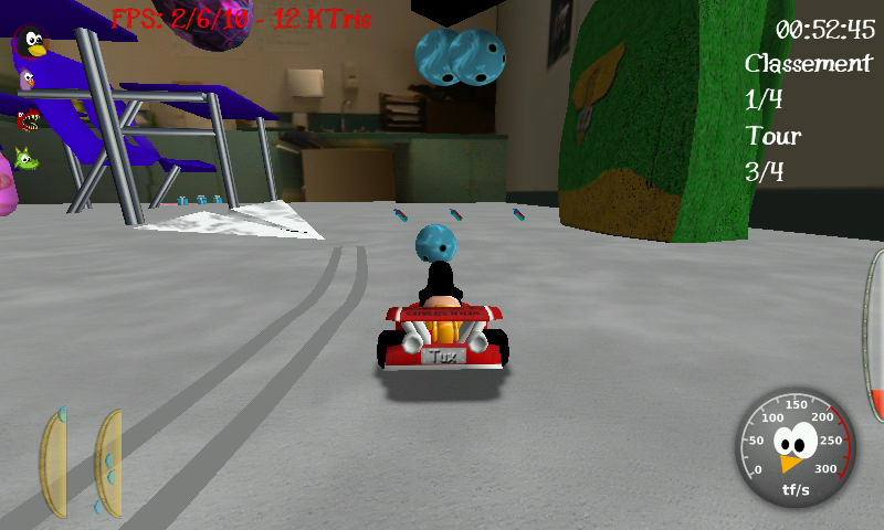

I'll dig up this old thread... I'm curruntly working on it. I have an Irrlicht engine running OK (the Demo runs at 40 fps, a bit more during flyby, a bit less when entering "the game"). Only GLES1 for now. I have just garbage on screen with GLES2. Will look at that maybe latter.
About stk. It's still a bit slow to my taste... With 3 A.I. running, I have around 10fps inrace. I have reduce many texture, to avoid bottleneck here, but it seems next bottleneck is either in bullet physics or A.I.., because when I race against only 1 A.I., I can easily reach more than 20 fps on the same track...
Here is an early screenshot, before reducing size of texture and some compiler optimisations. 130225-150750.png
I'll recompile with more optim... Than I'll try some neon code optim, if I can (and if I gain fps)... Than, I will also have a bit of work with GUI, as it's tailored for 800x600, not less (but it's useable on the 800x480 screen).

It is version 0.8 I'm using. I haven't tested yet the donwload part. Won't be that usefull, as I suspect the texture will be giant again and kills the performances :(
Might be good if someone can reduce the polycount for the cars.
Good to see it working :)
I don't know how relieble the ingame fps counter is, but I haven't found a direct link between triangle count (that go from 7K to 30K sometimes) and framerates. There are some "low poly" models also, for somes objects (bananas, gift, I don't remeber). Haven't see if there are automaticaly used or not. Another thing to check (and se the effect of that).
