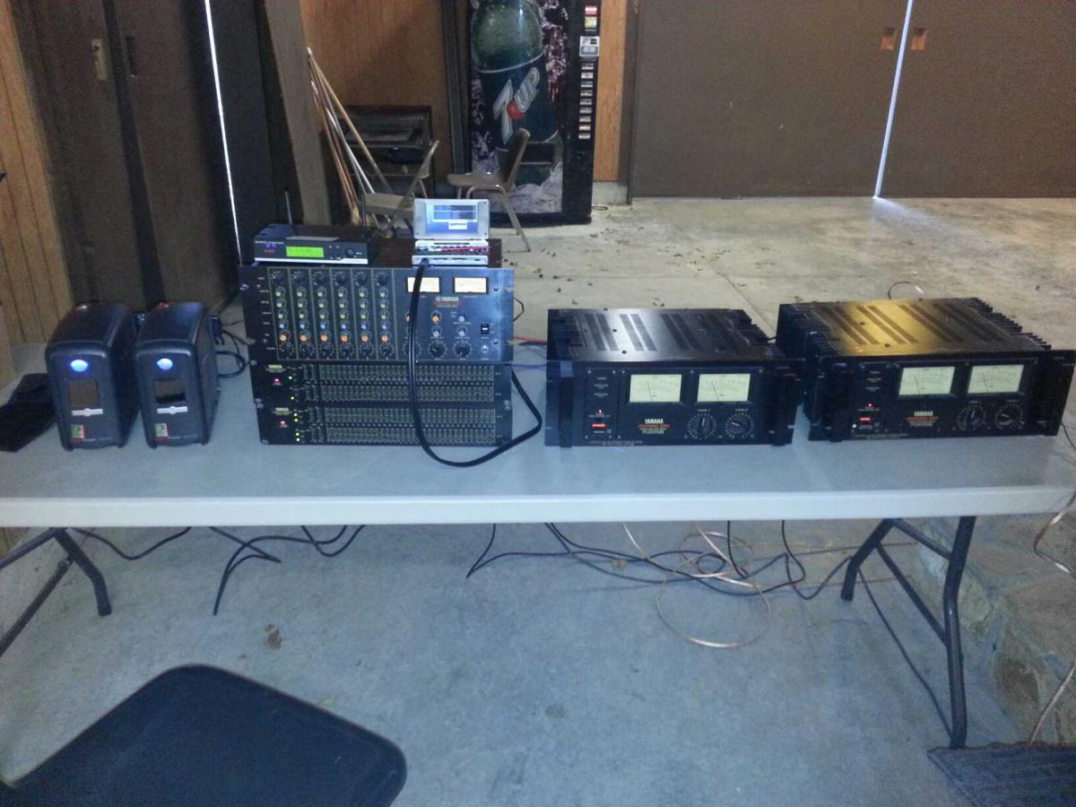

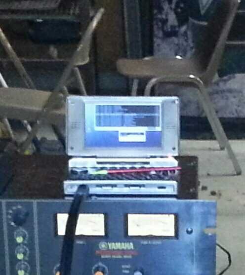

Here is a pair of photos. One shows what my Pandora did last weekend. The other zooms in on my current stylus.
The red  stylus shown above is composed of two 5mm outside diameter threaded hollow aluminum standoffs with threaded headless screws between the standoffs and from the front standoff and the dart tip.  The tail end is a machine screw with 6mm shoulders.
It fits -perfectly- in the Pandora's stylus slot.  The tail screw gives something to grab with your thumb to slide it out.
Total per stylus parts cost is under $5.  The key was finding the -long- 2BA threaded aluminum standoffs.  These particular ones are from the industry that has built up around homemade drones.
I have enough parts to make a few more.  If ED sees this thread and states his interest, I'll send him one for free with a complete parts manifest and a list of the suppliers I got the parts from - eliminating the tens of hours of research that went into me figuring it out.  He's welcome to do whatever he chooses with it.
