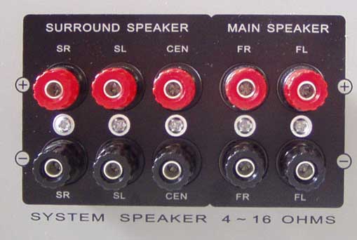

Second question: After so much searching, I'm weighting up the adquisition of one of the following amplifiers:
Skytronic 103.153
Power supply: 230Vac, 50Hz
Impedance: 8 ohms
Output power (PMPO): 2 x 140W + 3 x 40W
McVoice HVR-80
Impedance: 8 ohms
Output power (PMPO): 2 x 80W + 3 x 30W
As you can see, both amplifier specifications say they support 8 ohm speakers, but on the back of both amplifier they state different impedance values (!!).
As far as I know, the impedance of an amplifier should be the minimum of your speakers, as the lower is the impedance of the speakers, the higher will have to be the voltage applied by the amplifier to the speakers to generate the same power. ¿Am I Right?
With the speakers I have, ¿what's taking more risk, the speakers or the amplifier?
It seems if I raise the amplifier volume a lot, I'm going to trash it, as it's going to have to generate higher voltages to feed the front (80W, 6 ohm) and surround (25W, 4 ohm) speakers, and the amplifier could get warmer than hell, huh? <_<
Can you please advise me about this topic?
