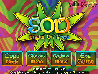

My first port to the Caanoo is now available to download from the Archive. I've made some minor changes to the game in this release, I've moved any text that was obscured by the Caanoos bezel and I've improved the wave effect to remove some annoying noise I noticed.
Download
SOD is a basic game of snake - its just this snake likes to indulge in recreational drugs.
Features
30 Levels
2 Game modes
8 great music tracks (Courtesy of Pat Ferguson)
Separate highscore for each map/mode
Several control methods
Adjustable game speed
A few secrets
