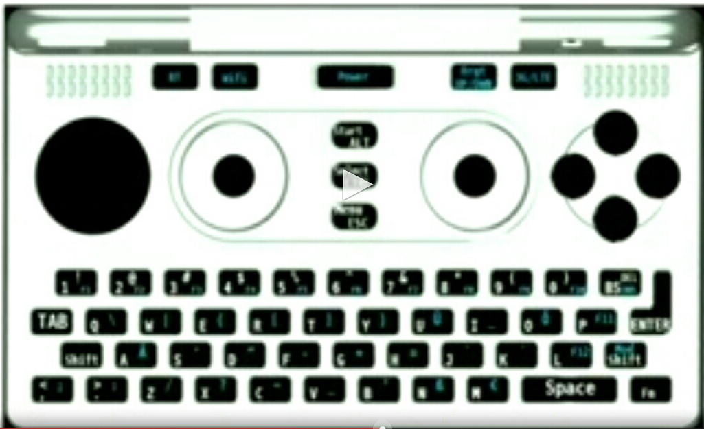

Which 5 keys do you need exactly? On a standard QWERTY keyboard, there are 8 keys to the right of the letter keys:  [ ] \ ; ' , . /   -- which ones of these do you need? Is it the same for all international layouts?
IIRC sweden has pretty much the same layout as finland:
You may notice some differences to the typical QWERTY keyboard in the key layout.
I grabbed this from EvilDragon's FOSDEM presentation.
PLEASE NOTE!!!!
EvilDragon has always struck me as a very nice guy, and all around competent person. Please realize that none of this discussion should be considered an opportunity to make demands. It should be a discussion which is based on useful opinions which people have actual experience with. (Example: I have owned many devices including the Pandora and Zaurus so I will speak about them. On the other hand I only speak English and will stay out of the discussion about the extra keys required for some languages other than English).
Having said that I have some notes about this proposed layout...
That TAB key is awesome. The Pandora lacked this.
I love the numbers being below the controls, but it may be unavoidable to keep them up top since the fourth row could be used for modifiers, language-specific keys, and a larger space bar. The 3 rows on the Pandora were lacking.
An escape key so so would be very useful.
Why is the fn key still on the right? Most people are right handed. Right-handed people will hold the Pandora with the left primarily. The hand holding the device is the modifier-key hand. This is why being able to swap these to either side is critical. Who cares what the keys have written on them?
Any other ideas? (Based on fact, not unsubstantiated opinion)
Unstaggering the rows would give us two more keys and splitting space would give us a third. We need another poll :)
No more polls on number of keys or placement.
We just need ED to give us a clean picture of the 'top side' of the board where the key switches are. Then we can argue for the next month and a half on where to put the ~.
I have some small unstaggered qwerty keyboards and they are unbelievably terrible. I am not sure why it makes such a difference.
I actually don't care. If the physical layout is good I can map whatever I want wherever I want.But the physical layout is the important part. If it's bad it can make it impossible to map everything the way people want. That's why double wide or otherwise differing key sizes are bad.
