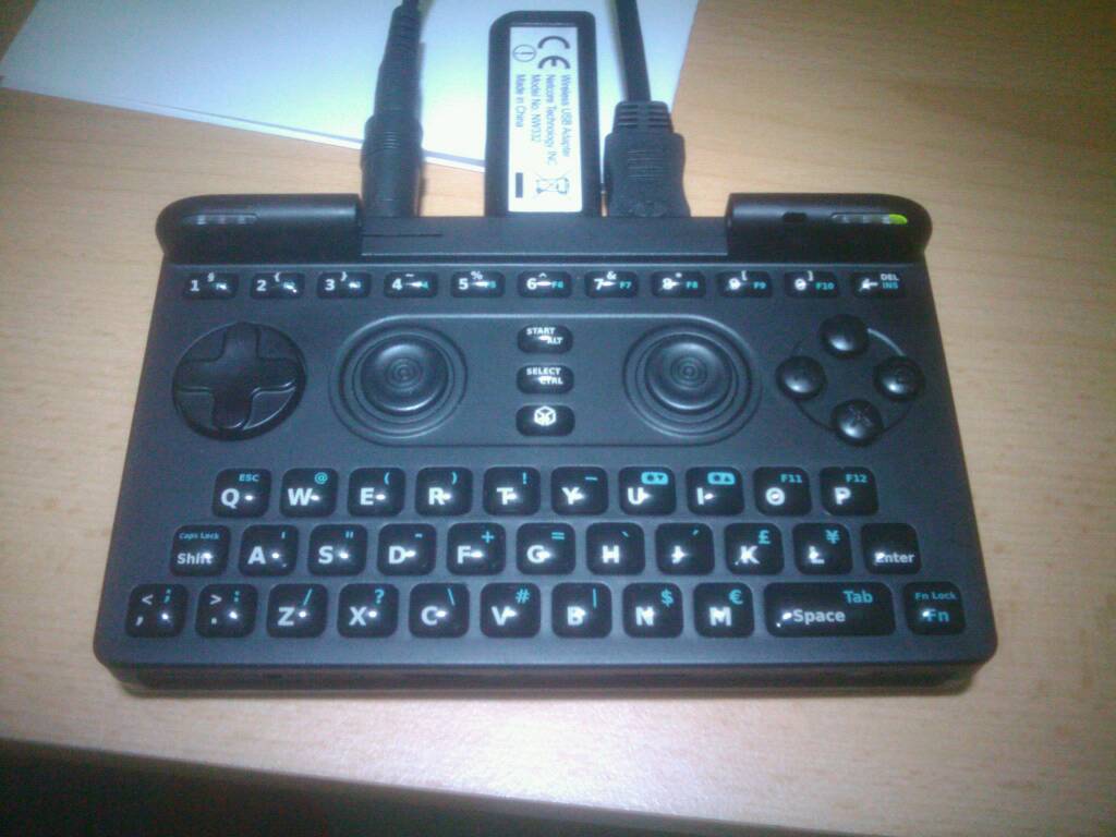

Smashed Pandora Rebirth
Whooot :eek:
Yes, case, LCD and probably the coil that drives the LCD needs to be replaced...
Or an Idea is to Buy a new Pandora and use the old as
Gaming Console without Display on TV.
Is just a Idea.
Dont worry about my Photo,because no Pandora got hurt or is died for this Photo ;)
I did give that some thought, however I didn't enable tvout and I can't see the interface to enable it on bootup.  So I can't figure how to enable tvout without seeing screen output to enable it blindly....
I'm assuming it's all functional only based on watching the led's on boot up.. impossible to see anything on the screen.
