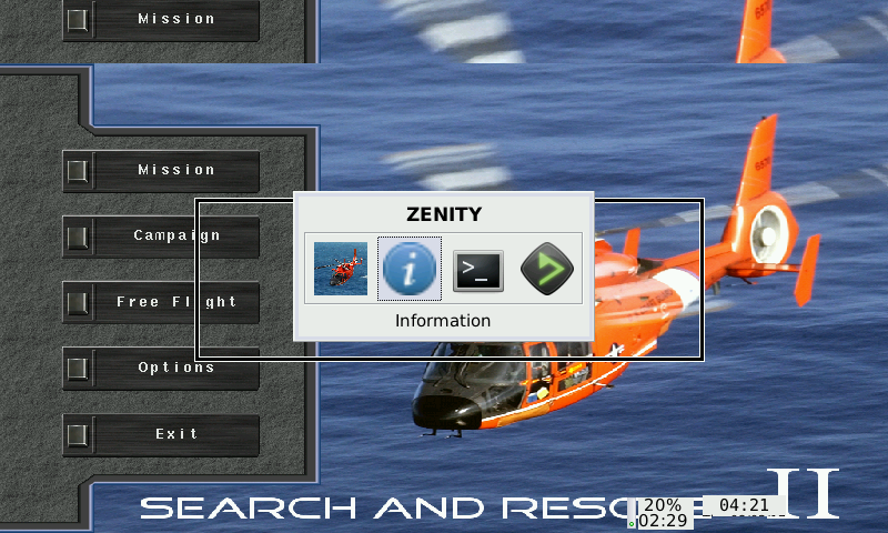

I tried this just now, and had some trouble with it. It would render a slightly corrupted main menu, but then just dump me back at the desktop (but forcing me to redraw the window to see where everything is). It hasn't crashed though; ps -ef shows it still running, and if I kill -3 it it goes away and the pndrun.out just says it's quit.
Maybe I should reboot my Pandora though, if this is just me. I rebuilt the battery padding a week or two back and it's been continuously up since then, and sometimes it does get a little screwy eventually and need rebooting. But I can only really tell when games that should work fail to.
So I've rebooted my Pandora now, and I get the same effects - it's drawing the game menu screen (although repeating 'mission' towards the top left), but it seems to be a window inside X and I can't get it to accept any inputs. Perhaps this is because I'm running this through the TV out, but I haven't had any trouble running anything else through that apart from some old programs apparently forgetting to switch the framebuffer output.
Ah, strange. I never tested this one with TV out. The X11 part of this game is a bit ... hum, over-reactive. Can you try to Alt-tab out and in of it?
Yes, alt-tab between it and anything else I'm running works fine, and it forces the game to redraw its screen apart from a few lines at the top. But it doesn't seem to accept any input.
Mmm, so X11 is still broken somehow. Can you try to wipe clean the appdata/sar2 folder and try again, without TV Out if possible the 1st time, to see if it does work?
My unit has a broken LCD, so I can only use it with the TV out cable. Someone else will need to try that out of it's needed. But I'll certainly try wiping the appdata.
So, I cleared out the appdata and rebooted (the appdata only included an empty home folder anyway)

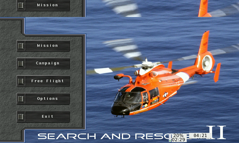

^ That's what I see when I first launch the game. As you can see, window furniture gets redrawn over the top of it, suggesting I'm still in the desktop.
^ Indeed I can alt-tab to other processes. Quite often when I alt-tab away and then back, that top bit where the screen is repeated, in those screenshots doesn't get redrawn. There's a window titlebar saying 'search and rescue 2' at the top, but between that and the redrawn part of the screen is the existing window from behind it still showing.

Thanks, that does seem to help. As you probably know, LIB_FB=3 makes it appear in a window with the expected furniture at the top, and from there is all seems to work, albeit slowly. I also tried with LIB_FB=2 and from there it appeared against a black background and and doesn't have window furniture popping through. Now however, my mouse seems misaligned in that I need to hover above the button to be able to click on it. This experience made be realise that it is running normally with LIB_FB=1, just I need to misalign my clicks in a +y direction, and click above the buttons, rather than on the labels which I'd previously been trying. I guess I should have been paying more attention to the screen animations, although that's a little difficult with repeated screen chunks and window elements popping through the screen.
