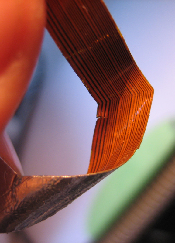

I've just got my upgraded Pandora (CC -> 512MB GC) back from ED and the LCD's not turning on. I've opened the lower half of the device and to check if the display cable was connected to the board which it was. I replugged and fastened it just to be sure but it didn't help.
Any ideas? I don't really want to be without my Pandora for another week but I much less want to buy a new LCD because I broke the current one trying to fix it.

Something like that was probably going through my mind as I disassembled my Pandora to find the LCD cable broken. I hope that wasn't me trying to get it out of the case o_o"
Sadly, dragonbox doesn't have the cables in stock right now ;_;

Success!
Ed sent me a new LCD cable, I put it in and it works!
Replacing them is one scary procedure o_O These cables seem so delicate.
