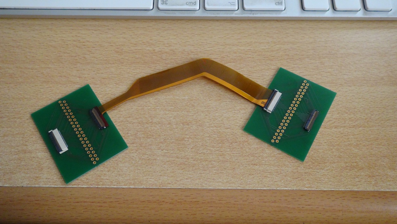

[doublepost=1477697332,1477696985][/doublepost]Quick update:
Nikolaus finished the tester PCBs and made some tests.
Our LCD Cables are working perfectly fine with the connectors!
Hurray! So most likely, we won't need another sample run - these would be ready for mass production :)
To make sure it's not something else that's broken, I will try the tester with one of the cables which has the too-thick stiffener and see whether it damages the connector or not.
