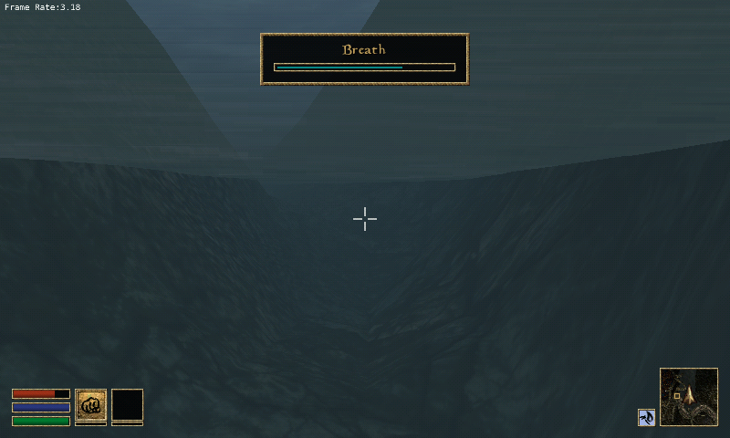

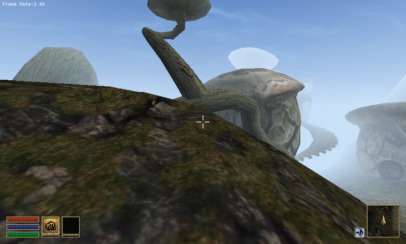

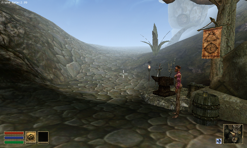

Here, some picture, running on the Pandora of course. There quite some swap, so the increase in memory of the Pyra will also help.
Now @klapse about that RPi test. I wanted to see how the Pandora (for a start) compared, but it doesn't seems GeeXlab is opensource (I was unable to find the sources to build it myself, only prebuilt stuff), so there is no way I can build the test on the Pandora (and later Pyra) to see... So that benchmark is useless (or at least, not universal enough). But I can run GLMark2 in GL2 mode...
ptitSeb
Serial Porter
Aug 15, 2012
8,981
48
France, near Lyon
More than 2GB of swap?
No, I don't think so. I use a huge swap of 4GB on my Pandora (mainly so I can build very large stuff, I rarely need that much memory), but with openmw, just a few is used, but it still swap constantly as soon as I move.
