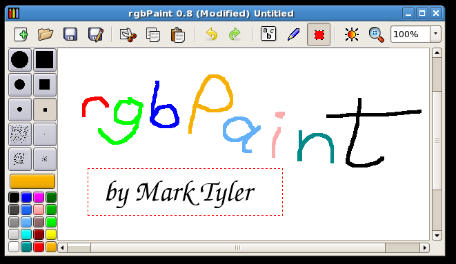

I use RGBPaint on Linux and thought that it would be a fantastic starting point for making a custom Pixel art program on the Pandora.
Can't get the damn thing to compile though and I wouldn't have the coding know how to tweak it yet if I did.
Raspian sources are here for anyone that's interested :)
^ That looks a lot like mtPaint?
EDIT: Oh, Mark Tyler is the original author of mtPaint, that explains it.
:D
That's one of the reasons why I thought it might be a good starting point for a project for some one. It already has the pedigree ;)
There is very few things that would need tweaking to make it a perfect fit for the Pandora in all honesty.
