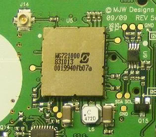

So wait, MWeston is going to be replacing a resistor on the first 500 boards, by hand? Or does he have someone else to help him? Because that seems like it'd take at least a couple weeks, although it's pretty moot if it fits in with all the other assembly procedures.

54Mbps is the theoretical limit. You don't get anything like that, in my experience, in real terms. However if it's a resistor change what's impeding proper and full 802.11g operation now? It's good all the boards aren't assembled then :) It's really good news that the issue has been found but what's stopping full speed operation then?

Not mentioning that if you need to decrease the value you can simply solder one "on top" of the existing one - no desoldering needed and damn fast to do (under one minute even counting taking the resistor and board and putting it back) by someone who is used to soldering smd's.
Even desoldering the existing resistor first will only add a little more time if you use a decent smd workstation.
Manually changing one resistor should be timewise faster then the assembly process, so ONE person soldering instead of assembling the first 2 day's or so.

Good news: The modification is minimal and can be done within a few minutes. We told the company to send the boards already produced and tested to UK ASAP and Michael will go there and start modding.
Then we need the cases - and assembly will finally start.
As far as I know, they still plan on soldering on the nubs by hand, so the resistor should be nothing :unsure:
