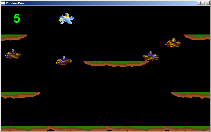

small update on Panjoust: i now have platforms working as well, enemies also nicely change direction when hitting them. Starting to feel more ready for release.
The only thing is that somehow, with my tilesheet for the flying bird, the transparency is broken again, while we used the same colour as a background. :unsure:
Update on PanJoust
I found the problem i had with AnimatedSprite in my version of the framework, i included my adapted version of AnimatedSprite.h & .cpp, but dunno for sure if i did not exclude anything important. Everything seems to work though.
No video, but a screenshot of the latest version of PanJoust was possible. As said, nice platforms, graphics of those will be updated, working hard on that. Also, i just inverted the colour of the hero spritesheet for testing.

Very very good I got PanJoust integrated now(Just in from work :lol:) I took a little glance at the code too. You could optimise it by making the enemies share the same AnimatedSprite object - Create a class or simply an array with all enemies positions and valocities and then you run through this info at render time and place the sprite at that position and render it, you can use a loop. It saves some RAM... although I think you are pretty much ok in this mini game but it would be less images loaded, a good tip to remember.
One disadvantage is that all enemies would be on the same frame of animation at any one time, but it's still useful to know nonetheless.

Joust is looking pretty spiffy. MarkoeZ, do you have anyone working on upgrading the platform graphics? If not I could probably throw together a quick set to replace what you have there. Let me know, I haven't flexed my pixeling skills in a while now. :)
PokeParadox: I made a function setCurrentFrame in (on?:unsure: ) the AnimatedSprite class, works perfect!
Yamara: I'm familiar with vector graphics, where i used them they used EPS for allmost al if them though, did not know PDF had that function as well, thanks for the info.
Eniko: Be my guest! this is a community dev thread after all ;) , all input is welcome!
