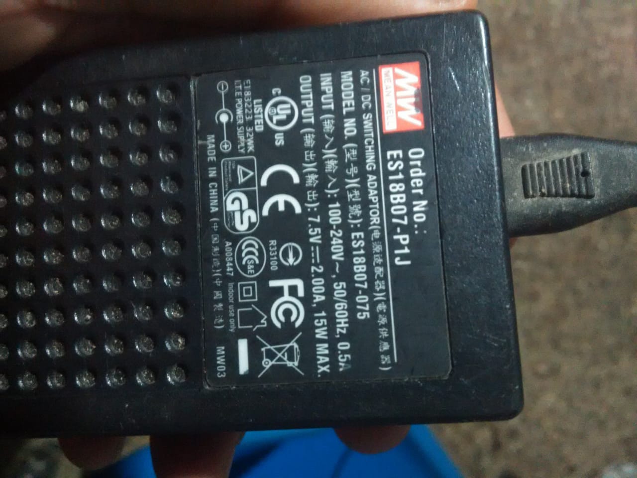

Would I use this one for powering my Rebirth?
