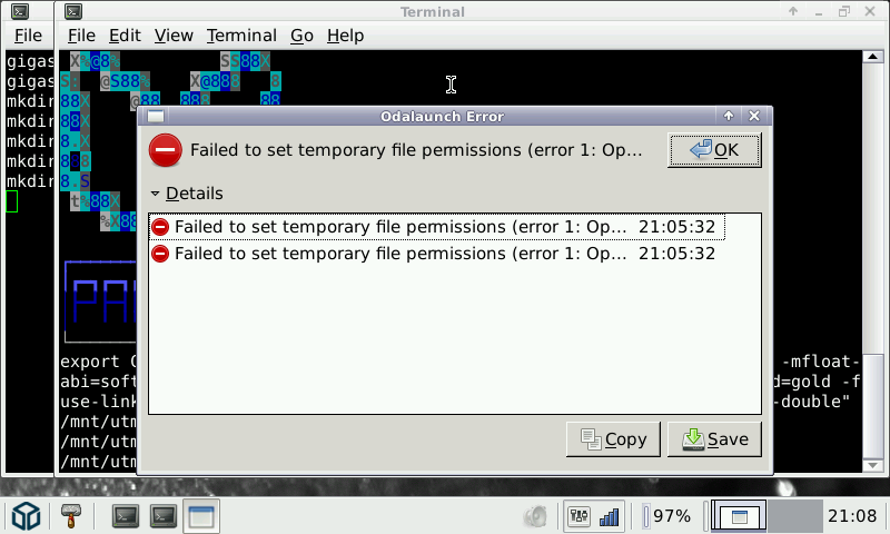

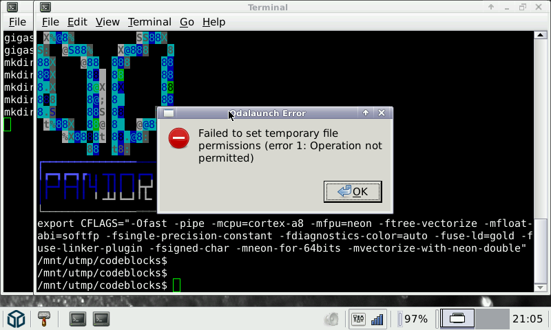

So here are the screenshots of the error. Not much inside. Probably trigerred by wxWidget, but not sure yet (and I check, you seems to have the same version as I have in current codeblocks pnd, but the one in wxWidget is older)...
Hi all :)
@ptitSeb : thanks for the screenshots, and sorry about the late reply !
If I understand correctly, these errors are not blocking, right ?
Cheers, Magic Sam

True, it´s behind while it´s running, and possibly the reason I do not find an ongoing network game with more than 0 participants.It pops up visibly after closing and says:
"Failed to set temporary file permissions (error 1: operation not permitted)".
Since I use it for single player only anyway, no loss to me :) for me it´s more important it is fullscnreen and that brightness can be easily adjusted as it is :) ran the timidity installer once again and now music works :)
Card I use is indeed formatted FAT32; type "UMOX SDXC class 10, 128 GB"; latest firmware, driver is default, to which I returned a while ago due to issued in the Emu Ex emus.
have a nice Sunday all :)
@atari_afternoon : unfortunately, this has nothing to do with this bug :( There are just very few people playing Odamex right now. Check the network status here (at the top of the page) for instance.
On a side note, there is an online competition every Friday at 7.30 p.m (EST), called Odamex Nitro.
EDIT: @ptitSeb : @atari_afternoon has the same file permission error you have. Do you still think it could be related to wxWidgets ? Should I report this issue on the Odamex bug tracker ?
Cheers, Magic Sam

@Magic Sam : yes, probably the same wxWidget problem. I don't think Odamex team should be contacted for that, it's probably Pandora specific (only Linux machine where you run software from FAT32 partition I guess).
