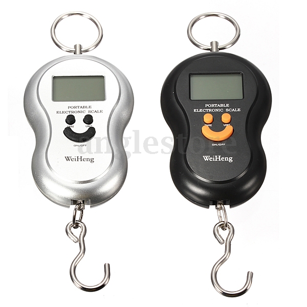

I need to find a digital hang hook scale circuit board.
While there's plenty of cheap pre-made models available like the ones in the picture, I need to buy naked ones where I can electronically read the weight from.

I'm not sure if you'll find one that has exactly what you're looking for up front, but you may be able to open one up to see if there's anything you can interface to.
I know that even cheap harbor freight calipers have a data output, so you might get lucky taking a cheap scale apart and poking around it's board.
Edit: I did do a quick search on load cells that can do tension or compression, but most of the ones that came up were $600 and up, and I can't imagine you want to spend that. But, you could buy a cheap digital scale like you have pictured, and rather than try and interface with whatever weird IC may be in it, just use the load cell directly. Most load cells are just resistors that change resistance under load, so I can't imagine it would be too hard to take something like an arduino and just measure the resistance of the cell.

I would suggest you get one you like, take it apart and see how the measurement cell is driven (take a few data point weight vs. voltage), then cut out their electronics and hook up your own micro to the cell to measure it ... will take a bit of tweaking and calibrating but most of these cells are somewhat linear or can be approximated
