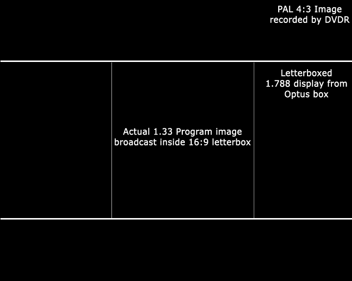

The best I have done is modify the tvout script to use a smaller vertical resolution (~400 lines) and this puts things in the correct (letterbox) aspect ratio. However, when using this letterbox resolution I also get pillarbox (borders on all sides) when viewing native 4:3 aspect material like Neo-Geo games on an actual 4:3 screen.
This is is what results. Ignore the DVDR and Optus box labes as this is the best image I could find to illustrate the problem.
The center box to outside borders ratio is what I get using Pandora's TV Out to display 4:3 output:
