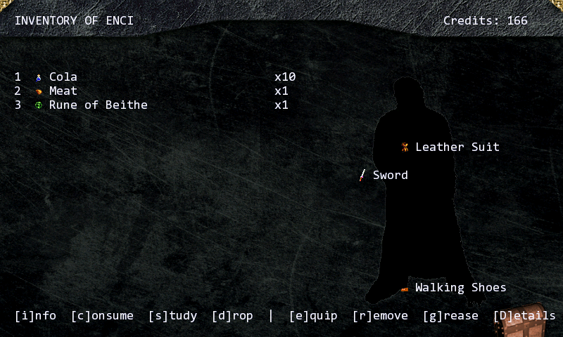

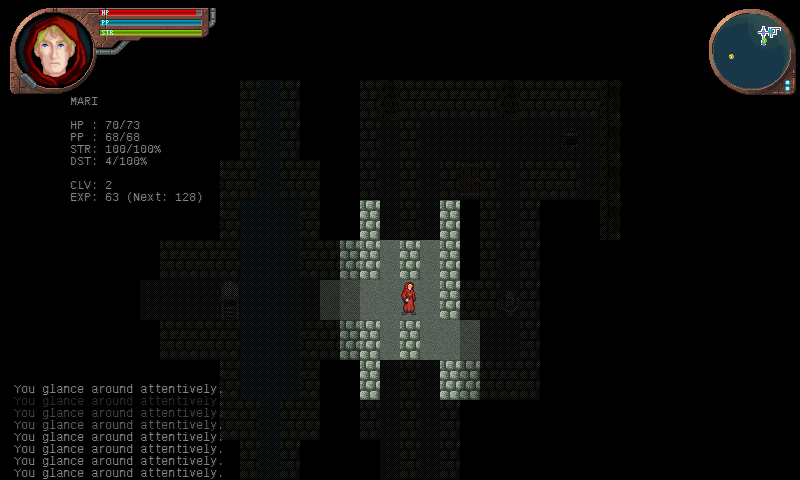

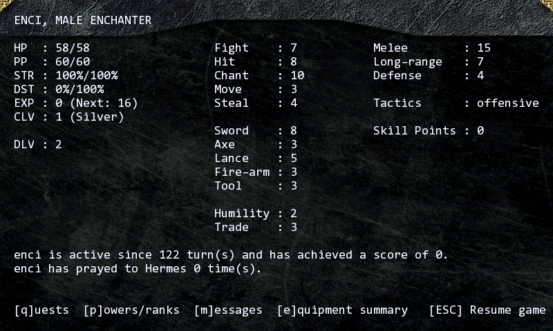

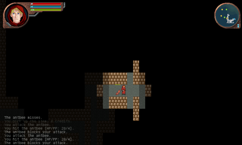

Edit: Can anybody post a screenshot of the port? I'd like to know how it looks.

My first try looks not so good, i have to cut your text from image and past into smaller image.
Screenshots from older version:

Edit: Move screenshot to attachment

EDIT: Sometimes I see a text display of character stats in upper left corner of normal dungeon display overlapping partly the character portrait, then it disappears when I switch windows (to take a screenshot). Where is this display coded? Is it supposed to always appear?
I found I can make it appear by clicking on character, which brings-up Status screen, then hitting backspace (esc) to return to game view. When I invoke it this way, it does not overlap the character portrait.
On a computer, this is a mouse over (like a tooltip) when the mouse hovers the status area in the upper left corner. There are also mouse overs for the action bar on the bottom of the screen.
