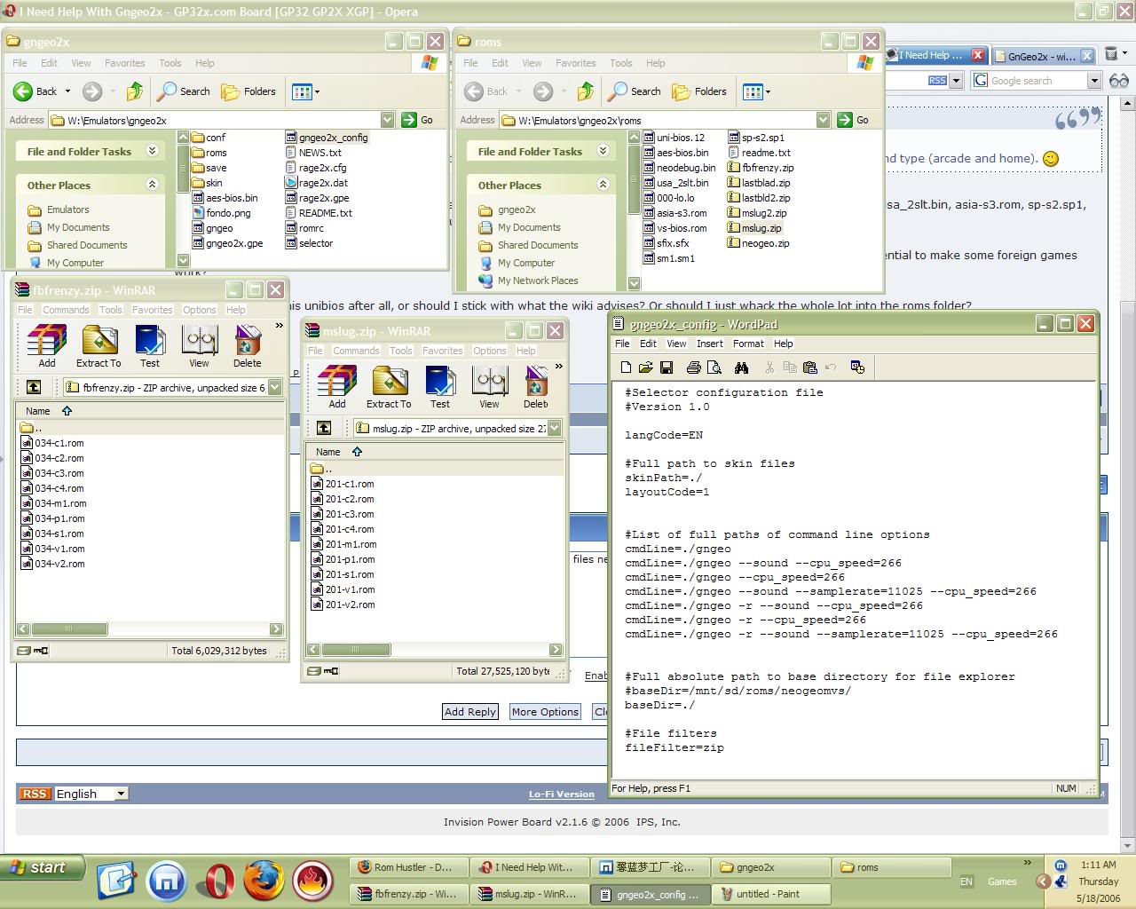

I have the same problem. I have all the files needed for the emulator but it doesnt work. Screenshot Below. My main directory is on the top left. The roms directory inside that is in the top right. As you can see, I have all required BIOS files. I also opened up 2 game roms so that people can see if they are named incorrectly. Also, I opened the config file. Whenever I start up the emulator, it goes to a black screen and goes back to the menu. If I use the rage GUI, the whole application freezes and requires a reboot. I don't know what's wrong.

First, considering your Sd tree, your config file should be :
#Full absolute path to base directory for file explorer
#baseDir=/mnt/sd/Emulators/gngeo2x/roms
baseDir=./
(add a "neogeomvs" folder and put your games in it if you want to point to /mnt/sd/Emulators/gngeo2x/roms/neogeomvs)
Your bios files seem okay.
If you want to be sure and test this emu here's the easiest way :
Unzip a fresh gngeo-0611 archive on the root of your Sd car, put your bios files (unziped) into "roms", put ziped games into the same folder ("roms") and run the .gpe.
There's no need to have the neogeo.zip bios file btw.

Alright, I think I have the answers. It is most likely the roms you're using. You're probably downloading them from the "Neo Geo" sections of your particular website. Once you open them, they all probably have the .rom extension. For example - for 2020bb.zip (2020 baseball), you probably got files like 030-c1.rom, 030-m1.rom, etc. That's incorrect. If you look at your romrc file, you'll notice that all the 030* files end in .bin. Since the internal file names don't match, gngeo2x will just quit back to the main menu right away. Even if you change your romrc file so that the .bin is replaced by .rom, it still won't work and will cause the system to hang.
So the way to correct way is to download the roms from the "mame" section of the website. You'll notice that in that section, 2020bb.zip has all .bin extensions internally. All the games found in the Neogeo section should be found in the Mame section too (if not more). This is the case in at least two of the websites I normally use.
