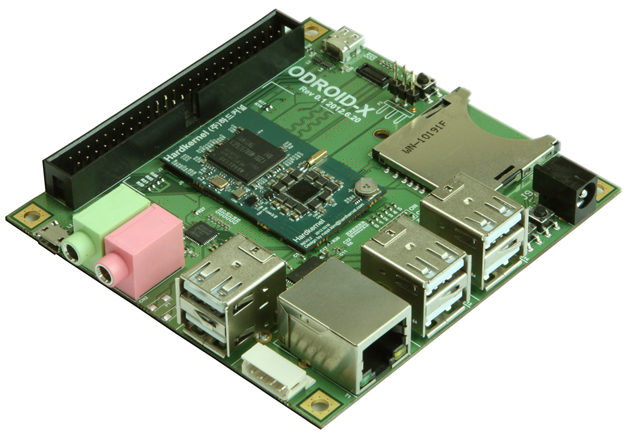

Now the $129 version Odroid-X daughter board, when mounted to the main board is thinner than the size a standard USB slot would take. Take note how much real estate a full SD slot takes.
Specs+ Dimensions
A Korean hardware manufacturer called Hardkernel is launching a high-end alternative. The company’s new ODROID-X board comes with a Samsung Exynos 4 processor, a quad-core CPU clocked at 1.4GHz. The board also has a quad-core Mali 400 GPU, 1GB of RAM, six USB host ports, an ethernet adapter, headphone and microphone jacks, and an SDHC card slot for storage.
With four times as much RAM as the Raspberry Pi and a much more powerful processor, the Hardkernel board seems like a nice option for more computationally-intensive usage scenarios. The system is still highly compact, measuring at about 3.5 x 3.7 inches.
Because the Hardkernel board is based on the Cortex-A9, which uses the ARMv7 architecture, it is capable of running the latest version of Ubuntu in addition to Android. Ubuntu doesn’t support the Raspberry Pi’s ARM11 architecture (the Raspberry Pi foundation recommends using Fedora on its board).
Of course, users can expect to pay more for the higher specs of Hardkernel board. It is available for $129, which is a lot more than the Raspberry Pi’s hobbyist-friendly $35 price tag. It’s still less than the $183 PandaBoard ES, however, which has a dual-core 1GHz ARM CPU and 1GB of RAM.
As you can see the limiting factor in regards to thickness are the connectors themselves. The limiting factor towards maximizing board real estate is the width of the things like SD slots that populate the board. I'm not sure how Craigix plans on making the device thinner, but I can definitely see how it is possible, even including full gaming controls, full hd out, 5 inch screen and a larger battery.
27055_02_odroid_u_is_a_raspberry_pi_like_device_except_it_sports_a_quad_core_exynos_processor_and_starts_at_69.jpg
The product in question is the ODROID-U, which costs just $69 but sports a 1.4GHz quad-core Exynos 4412 CPU, you know - the same thing that powers Samsung's Galaxy S III and Note II smartphones. On top of its quad-core processor, it has 1GB of RAM, a quad-core Mali 400 graphics chip, micro-HDMI out, USB ports, a headphone jack and Ethernet connectivity.

I considered a lot of them but most of your examples make mostly room in horizontal, not in vertical dimensions. At least if craig is persitant in the usb-port it is a given, dpad and Nubs will most likely be the same as in P1,ICP,ICP2 (cost factors). The S3 is no clamshell device so you will need to add a few layers of plastic additonally. Dont forget about the Keyboard, as craig stated somewhere to reduce costs the ICP2 keyboard will most probably find its way into P2, but looking at the pictures, the construction didn't look much thinner to me.
