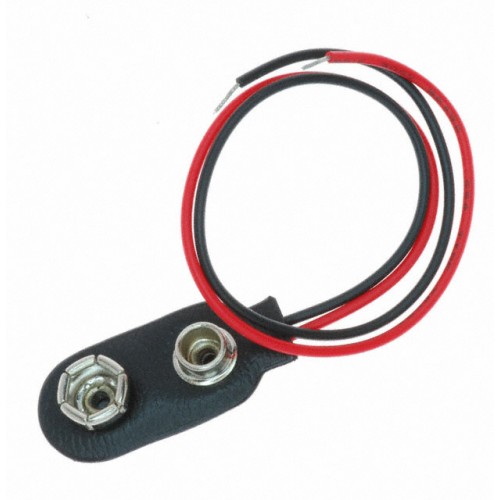

Those 9v connectors did (and still do) work very well!
