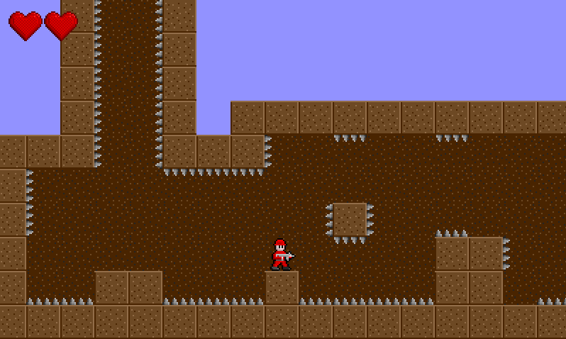

^ The game dynamics (movement, jumping) look spiffy and hectic. I can imagine some fiendishly hard levels in that game's future :P
By wastebin I assume you're starting on the SDL version you mentioned earlier?
This was level 3, I had designed it to make you go absolutely mad. I'm yet to complete it myself so I can't show videos of 4 and 5.
4 is about twice the size of 3 and 5 is mahooosive. I was going to bring in bullet functions and things but alas learning C++ will be jarring :(
All sprites are rendered from text and sound is also rendered as binary, I didn't think it was too shabby for a 54kb py file :)

Spikes, oh spikes... is there any place in a level they won't fit :P
On a related note, my game actually will have spikes and pushable boxes, just to fit into the cliché of the generic indy game, oh noes! (though I am not too sure about the spikes right now)
