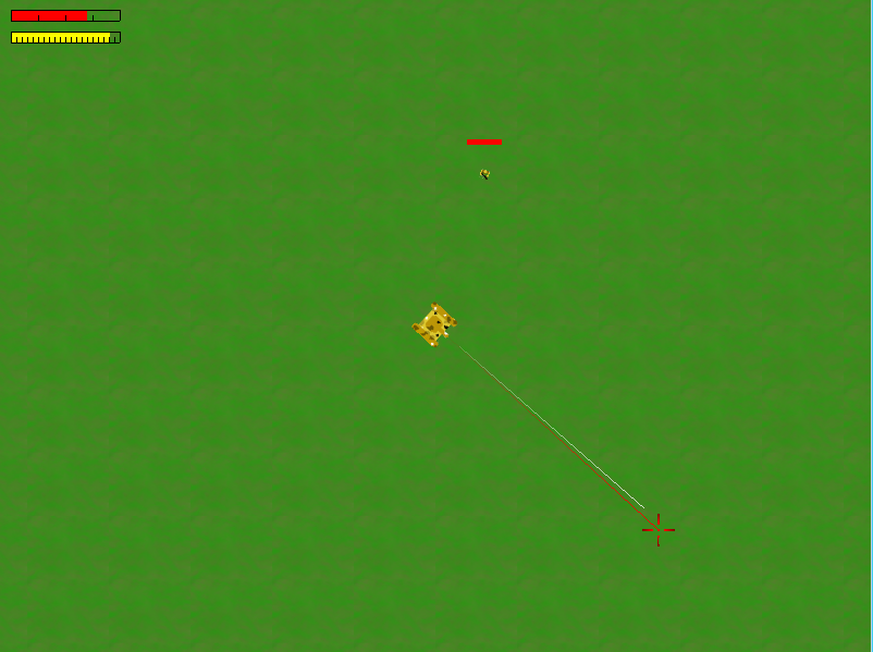

Hey there. I know it's a glorious day/wonderful evening, but if you find yourself with some spare time, I would appreciate it if you would check out my game. Before I begin, I want to point out there is not a Pandora port yet. I still need to convert the OpenGL code to OpenGL ES. Anyway, I wanted to make a game that took advantage of the Pandora's gaming controls. The original idea for this version of the game was to have two fully configurable turrets, but then I thought it might be too hard to balance all the choices, so I thought maybe having an autocannon on the left side of the controller and rockets on the right side of the controller. But I thought it might be too much for the player. The current idea is to have the left side of the controller be responsible for direct fires and the right side be indirect, but the right side isn't programmed yet. I bumped my old topic on gp32x, but I figured some people don't check there.
Edit: I'm sorry. Controls: Pretty simple at the moment. If a joystick is detected, the first two axes will be used for the aiming angle and button 5 will be used for firing. It may take a little bit of experimentation to discover which button is mapped at index 4. If no joystick is detected, the mouse is used. Point and click. In my rush to get this out there, I haven't tested use of mouse in the turret class too much, so there's a good chance it's buggy.
What are the controls? I can only seem to shoot in one direction.
From what limited amount I've seen, the game looks good, though the main menu could use a little work (resizing the grey boxes that appear behind the menu items).
Yes, I'm sorry. Those are things I forgot to mention. If the game detects a gamepad, then the first and second axes form the look control. The angle you tilt is the angle the player aims. Currently, I just have it set up to fire on index 4 of the first gamepad detected. On mine, that's L1, but it might be different depending on your layout. I need to set up something in the menu to allow the controls to be customizable. If no gamepad is detected, the game defaults to mouse, but I just added it last night and haven't really tested it. Just mouse over to the enemy and left click (assuming it works ok).
Agreed on the menu. It's on my to do list.
By the way, thank you for the feedback.
I'm playing with a mouse, as I have no (useable) gamepad. I'm not getting a pointer/cursor, however.
Ok, I'm getting that too. I'm working on it right now.
Also, what kind of comments are you looking for? Just general bugs, etc., or do you want suggestions on the game design?
Ok, I think I solved the mouse problem. It had something to do with the joystick and mouse code not playing nice. I'll upload a new version as soon as possible.
And I would be interested in any comments. Pointing out bugs, suggestions on game design, even programming tips.
Edit: New version uploaded. Sorry about that.
OK, played the new version, mouse appears fine. I'm having a problem where I defeat a certain number of enemies, and then it just doesn't send any more at me. Is it supposed to be advancing to a new level at this point, or is this just a proof of concept?
Also, what are you planning to use as the controls on the Pandora? You'll need to disable touch-screen input, or it will just become a test of how quickly you can click on different things. I had an idea for a design rewrite that implements the screen instead of the nubs, but it would be vastly different and I think the current version could work fine as-is. You'll want to tweak the nub sensitivity to get the difficulty right, though.
Also, I've found that when you run out of ammo, you can just click the mouse button again and it reloads completely. My suggestion would be to either have a limited amount of ammo per level (thereby increasing the difficulty) or having the ammo gauge deplete a lot faster, forcing the player to time his reloads against the waves of enemies (and in this case being able to reload partway through the gauge would be good too).

OK, I've had a bit of a play with the settings, and I've found the following pretty balanced:

This makes jeeps very difficult to destroy, and you will often have have to reload while firing at another tank, so if you want it to be a little easier then change magazine to ~30.
I've also noticed that if you die, the game over you are presented with screen does nothing. Worse, if you press enter you get an error in the program that makes windows insist on closing it.
I've also thought about the controls a little more. If you use say the left nub to control the turret, then perhaps you could use the shoulder buttons to use your specials on the location where you have your cursor at that time (e.g. one for an air-strike which is AI targeted to enemies, and the other for an artillery strike that hits exaclty the area you select). The reason I think that this will work is that we can assume that the players would only call in these strikes when they are in trouble, and this gives the player the choice of either continuing their attack or taking a penalty (the time penalty of relocating their cursor) in order to call in the specials.
Finally, and this is a bit more of a long-term thing: In thinking about how this game will function as a finished product, I don't think that merely advancing from one level to the next is enough of a reward for the player (though this will certainly be necessary), but perhaps including a scoring system could remedy this. I had in mind something along the lines of X points for each infantry, Y for tanks and Z for jeeps, ~1/2 normal points for units killed using specials, and -1 point for each shot that does not hit anything. Though this will almost certainly have to change to balance things later, but you see what I'm getting at.
Also, I just want to say that this game is better than anything I could do at the moment. If it ever sounds like I'm being overly critical it's because I want to help you make this game as good as possible.
